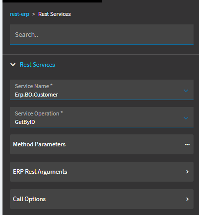

I’m using rest-erp action to call Customer.GetById

my setup of rest-erp action is simple:
I don’t believe in this case I should need to setup the “ERP Rest Arguments”
as I am not mapping anything to a dataview

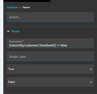

This is my condition expression (one of several variations I’ve tried

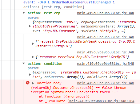

This is the error I am getting and the response payload showing the getByID call is working
I have tried several variation on the syntax for my condition’s expression, which is where I get an error (the error varies depending on the syntax I use)
returnObj.Customer.Checkbox01
{returnObj.Customer.Checkbox01}
"“returnObj.Customer.Checbox01}”
what seems to get me closest is:
in which case I get: syntax error: unexpected token ‘.’
this implies to me it likes the {}'s and understands what returnObj is ???

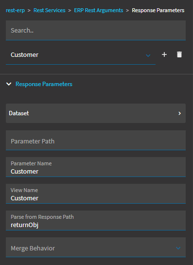

I was able to get this to work by using using rest-erp → “Rest Services” → “ERP Rest Arguments” → “Response Parameters” for my rest call as follows:

You may still need to tell it returnObj and Customer for the “Parse from Response Path” and “Parameter Name” respectively, but you don’t need the view.

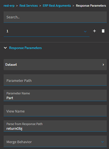

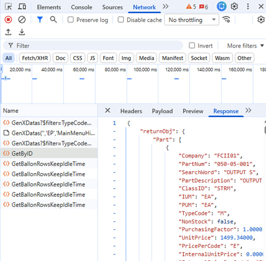

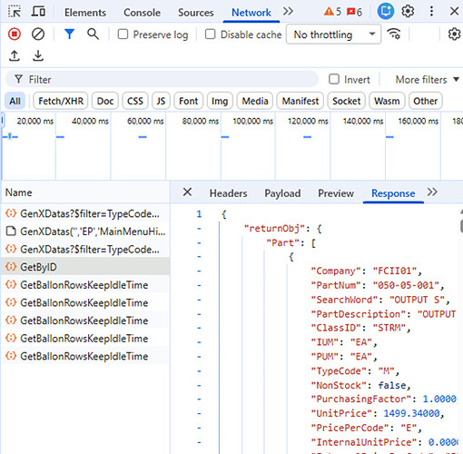

Thanks to all that have shared on this so far. I really feel incompetent with Application Studio and debugging. I’m trying to implement basically this very same thing for Part and I’m unable to get the resultant data pulled out. Using the same erp-rest widget for Part GetByID, I see the data queried successfully.

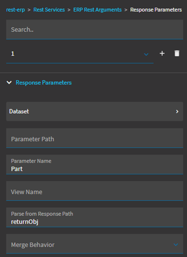

Taking Hannah’s suggestion and leaving the View Name blank, my response parameters are.

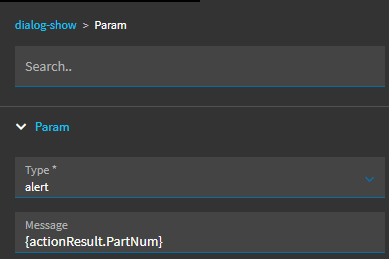

For testing, on success, I’m using a simple dialog-show configured with an alert and the {actionResult.PartNum}
When the dialog fires, it comes back with undefined
I’ve also tried including Part in the View Name of the Response Parameters…knowing it would then need to be {Part.PartNum} but it fails with the same undefined.
They may have changed the actionResult behavior. You’re better off creating a Part data view, then defining the view in the response param and using the data saved to the new view.
