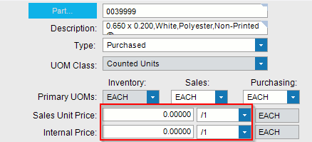

EDIT: Included pictures show Purchasing being able to edit Unit Price while Engineering cannot
