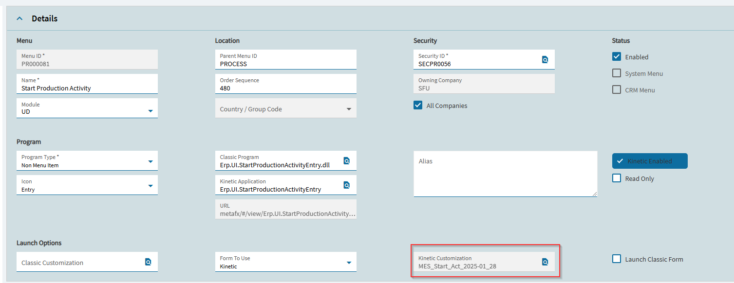

another issue, added customization in menu maintenance, but in MES it opens without modifications:

Is the customization Published (in App Studio)?

yes, i found this KB KB0132464 this works, but looks too many steps to add customization

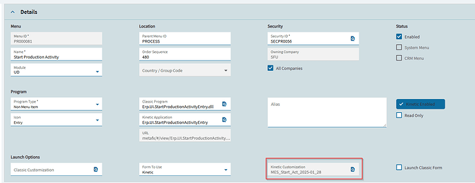

You have to add a new event on the Start Activity button to call your custom Start Activity Layer.

Yes, but you need to get to them from Application Studio directly.
Open App Studio, turn on your filters, and filter by “startproduction”
Below is an image showing my filter results with both the base epicor layer and my custom layer.
[image]

With that layer published and added to your menu… you now need to also edit your main MES screen.
So, you pull MES up in App Studio.
