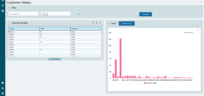

Here’s an example.
Welcome to Kinetic…

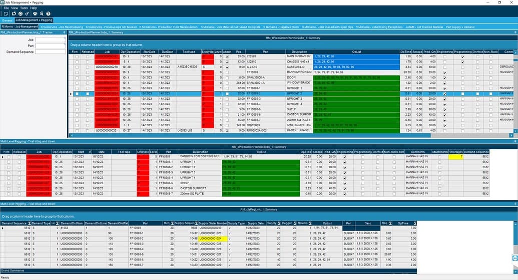

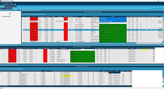

    @hmwillett - do you believe I can replicate this Dashboard or get “pretty damn close to that” using the Kinetic UI?

I do, yes.
The only thing that you’ll have a reduction in is, as Dean called it, “data per square inch.”
I can make the Kinetic dashboard look exactly like that, except the number of columns shown per grid. Unless you zoom the browser out which is an option unless you have an older user base; the old folks seem to complain about something called “bad eyesight.” :sweat_smile:

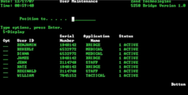

Back in the olden days, when I programmed entire ERP Systems in a GreenScreen version…
the UI was “easy” and everything had a place on the screen. Changing to a more modern “windows” UI was an radical change that many people had a hard time with. BUT over time, it became impossible to sell software if it had a greenscreen look

One of my Epicor implementations was from ProMan, a GreenScreen ERP System running on a Pick system - that was a challenge in itself.
Power users were lightning quick using that interface - it was impressive.
