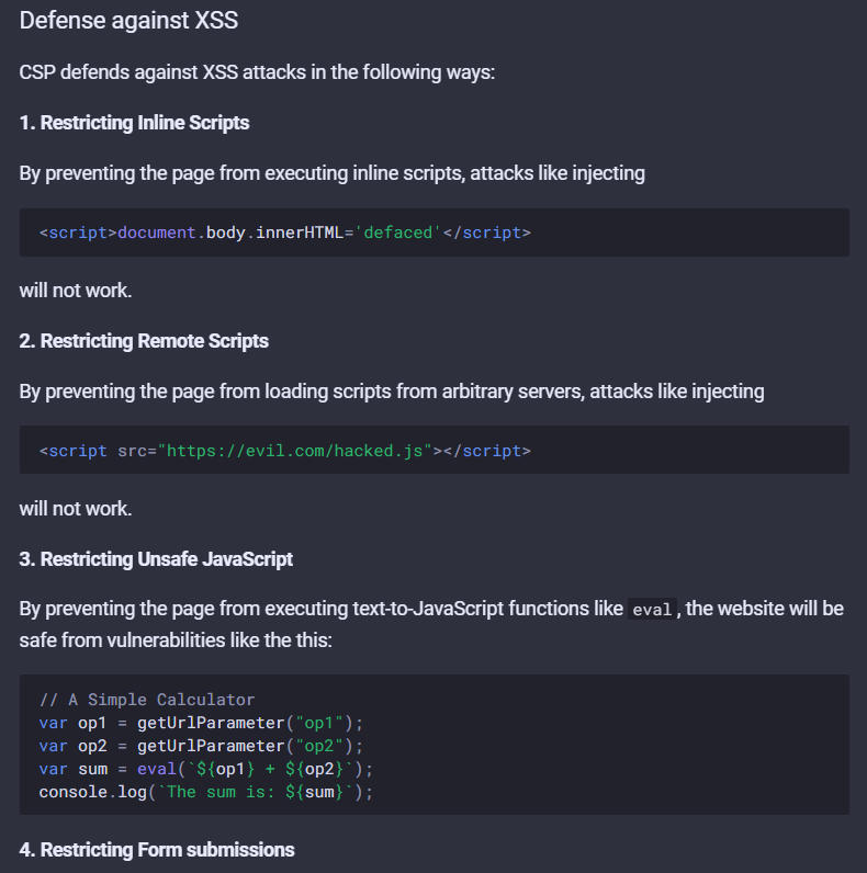

eval() can be blocked with security headers, so I wouldn’t hang my hat on the technique. From:
