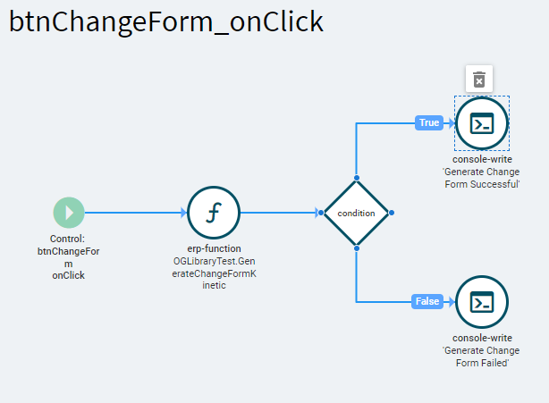

  • I have a button, with event that calls my function, and I’m putting a condition after the function to try to get my output blob and pass it to the JScript…but I am having trouble getting the syntax correct
This is my event handler:

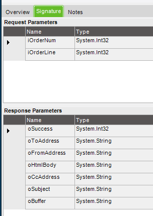

This is my function signature:
At this point I’m only interested in my output param “oBuffer”

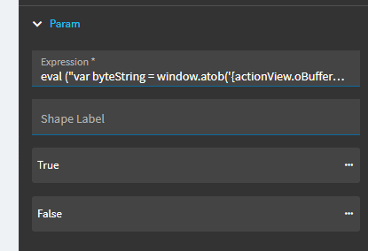

My Condition/Param/Expression is set to:
The full expression being:
eval ("var byteString = window.atob('{actionView.oBuffer}');let int8Array = new Uint8Array(new ArrayBuffer(byteString.length));for (let i = 0; i < byteString.length; i++) { int8Array[i] = byteString.charCodeAt(i);}let documentBlob = new Blob([int8Array], { type: 'application/pdf' });let fileURL = URL.createObjectURL(documentBlob);console.log(fileURL); window.open(fileURL,'_blank');")

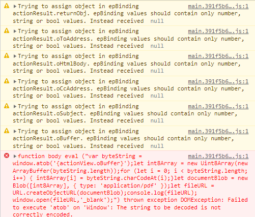

Using F12 (and ctrl-alt-8), I see these errors:
Note, all my output params are assigned a value of the correct type in the function,
but for some reason oBuffer and oSuccess don’t show one of the errors (in yellow),
also note the “actionResult.returnObj” which is not one of my return params.
For the error in red relating to atob, I’m thinking that’s because oBuffer is one of the params error’d in the yellow section.

Ignore those. 99.9999% of the time they’re red herrings and show up whether your stuff works or not. @bconner what’s the deal with those? Make them go away. :frowning:

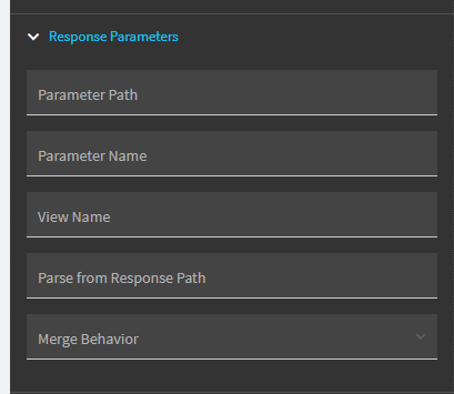

Show me the function widget’s response properties in App Studio.
@hmwillett Show me the function widget’s response properties in App Studio.
they are all like this (empty)
I have made some guesses on what syntax to put but to no avail
