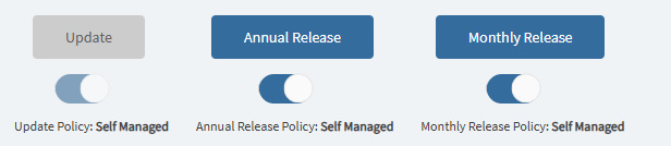

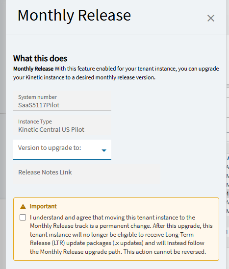

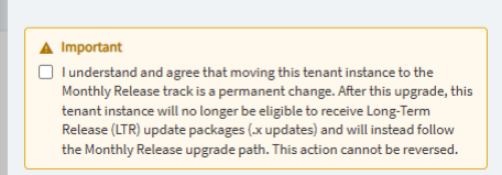

I was going to do the monthly update to 2026.103 on Pilot today since it is going to happen automatically next tuesday, and I found this Important message that now has me hesitating. I also have to note that the old “update” button doesn’t have any versions to upgrade to, listed, but this monthly one has 103 and 104.
Has anyone checked the “Important” checkbox and what is it like on the otherside? I am worried about not being able to get fixes anymore.
They are continuing to release dot releases against 2026.100 that contain fixes. Personally I wouldn’t do it, being Epicor’s beta testers 1-2x a year is bad enough. Every month?

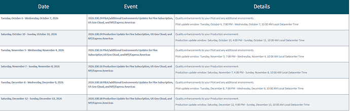

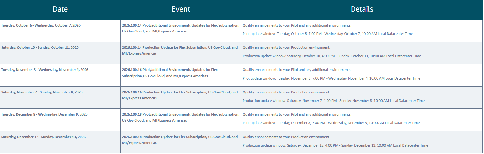

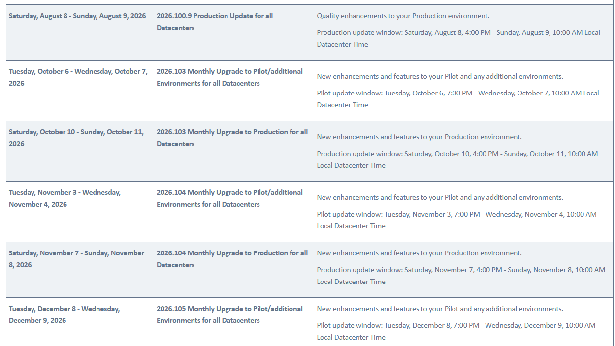

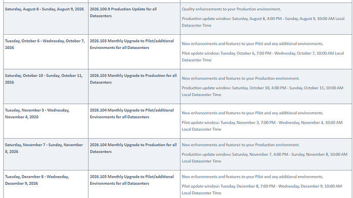

Nope, they are still releasing dot releases every 2 weeks. They do not make every dot available for cloud. Cloud will be getting .14 in a couple of weeks. Its all on the epicweb schedule. Sign In
And to save you from MFA:
Thank You So Much GIF
So why does the link you included take me to a schedule that shows 103 and 104 and not your screenshot of .14 and .16
oh looks like MT/Express Americas and US Gov Cloud Customers have the .14 and .16 route
There are two different schedules on that page. One is for CICD (public cloud/non-flex only) and a separate schedule everyone else.

The checkbox committing to the Monthly release track is now gone. Must have been removed in the maintenance update to CMP last night.

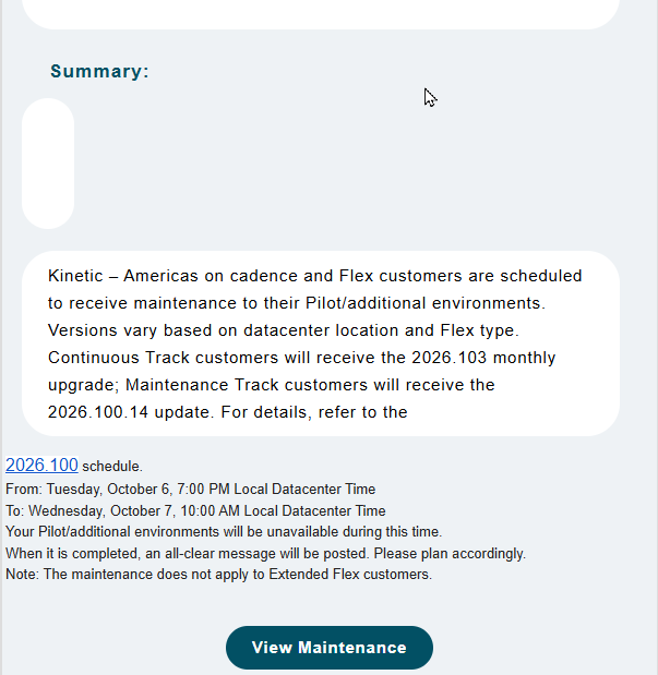

I think enough people opened tickets from that check box that they decided to remove it. I know that we had several tickets that were waiting on fixes and it took a few days to get responses. We were told that Public Cloud is going 2026.103 for the next update and will move the monthly cadence. Currently our Pilot Env is moved over and we are holding off as long possibly can to have our Prod environment move over because of some issue we found in the 103 release.
It doesn’t look to me like the customers on cadence have an option to stay on Maintenance Track.

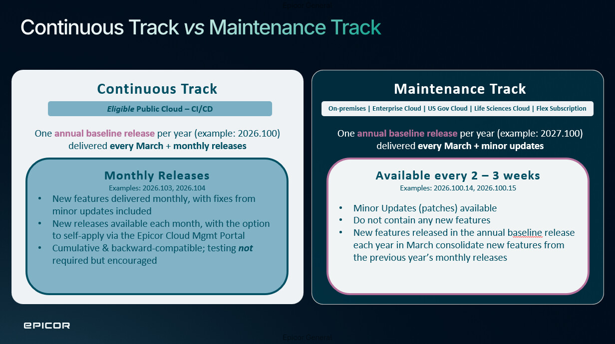

Continuous Track vs Maintenance Track​​
​The Continuous Track is for public cloud customers, while the Maintenance Track ​​is for on-premises, Enterprise Cloud, US Gov Cloud, Flex, and Life Sciences customers.
The Continuous Track d​​elivers one annual baselin​​e release each year, plus ​​monthly releases that can include new features, enhancements, fixes, and security-related updates. The Maintenance Track also starts with one annual baseline release, but after that it receives minor updates or patches rather than monthly feature releases. In simple terms: Continuous Track = annual baseline releases + monthly feature releases. Maintenance Track = annual basline releases + minor patch updates.
I also noticed that once upgraded to the monthly release, you don’t have the option to switch it back to minor patch updates (or Maintenance Track).
That makes sense though, the only way I could understand Epicor allowing you back would be on the next major release when in theory, both would be equal in terms of features. Because the ‘rolling release’ is pushing out changes to features I expect it would be difficult to have a customer revert back, probably not impossible but something I can understand Epicor having 0 desire to support.
