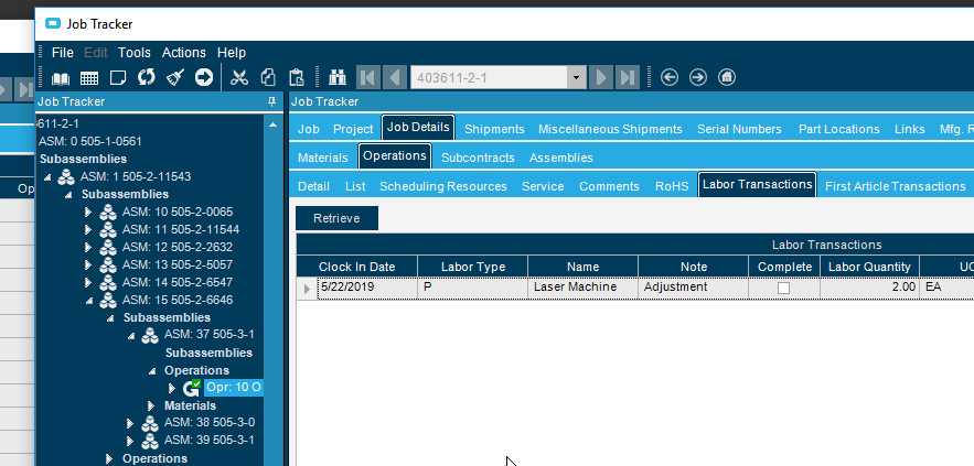

I’m pretty sure if you do a job cost adjustment, you don’t need a labor header, it just puts a labor header at 0.
You will have to populate everything, but there are places for it on the screen. I’m hoping that this workable this way, I’m in the process of testing it all out. And I need to double check the costing on this one to make sure it flows correctly. I haven’t done that yet.
One caveat is, labor header 0 doesn’t show up anywhere in the UI, so if you have to change something, you can’t do it with out of the box tools. You either need to “undo” it with negatives, or go the UBAQ route. And I don’t know what kind or ramifications that has.
