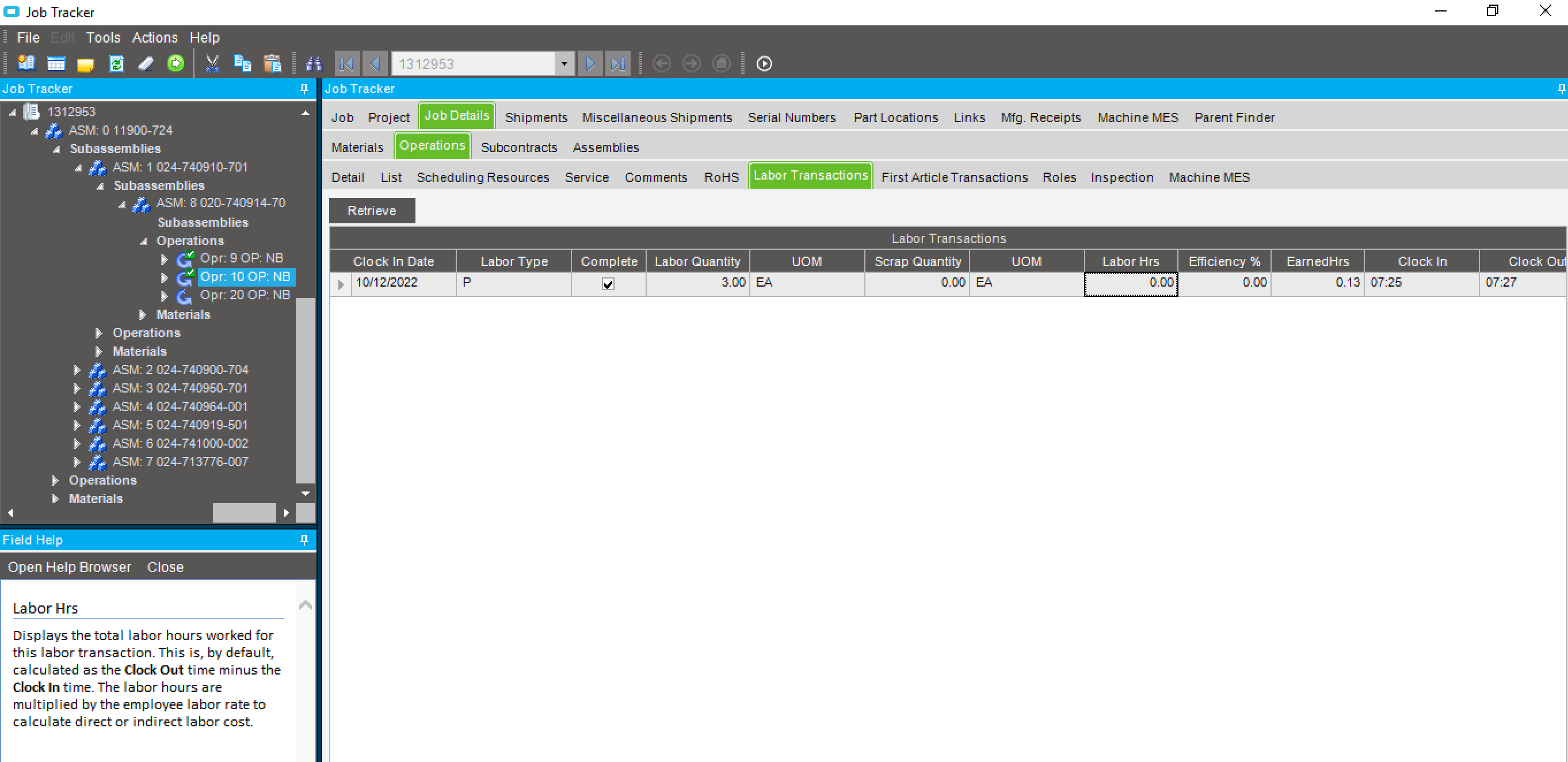

Labor Hrs = 0 on Time & Qty transaction where there is elapsed time
Hi, this is probably an easy question for those very familiar with this dataset. I’m trying to figure out why some of my labor transactions show 0.00 Labor Hrs when there is a difference between Clock Out and Clock In Minutes. I’m working on a query to show efficiency at the OpCode level.

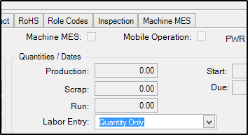

On the jobs in question, is the Labor Entry field on the operation set to Quantity Only?
No, these are Time and Qty

Interesting… this actually lines up for the Employee from the screenshot. The work was recorded during their “break”.
