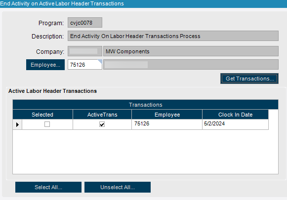

That code seems to work, returning 2 records:

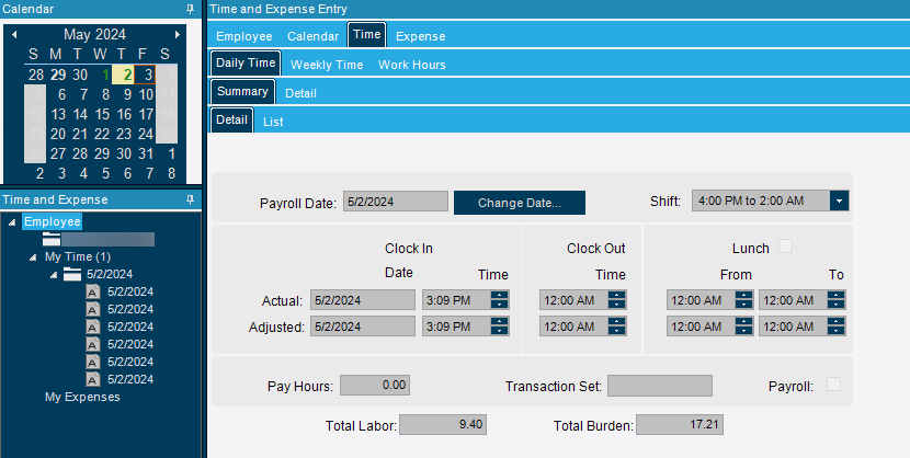

But, when I go into Time and Expense, it is showing the labor record as being closed out a midnight.
If I go into User Run Conversion 660, it shows that Labor Header as still active:
What would cause the Labor Record to still show as ActiveTrans = 1, but not have it appear as Open in Time and Expense?
The “clocked out at midnight” is tricky because the ClockOutMinute and ClockOutTime fields in the database are set to 0 while the person is still clocked in. The UI represents that as Midnight. Because the record is active, you cannot edit it in Time and Expense entry (everything should be editable in that screen) and the Pay Hours is set to zero.
So it actually is still showing as active in T&E.

For this specific record, I know I can just do the User Run Conversion 660. But, this happens on a regular basis and I would prefer that the department heads fix the employee records for their team rather than having to jump into the conversion workbench every day.

Running the End Labor conversion will change the ActiveTrans flag to false. It doesn’t appear to change anything else, so one should still adjust the time and mark the entry (for details) as approved.
