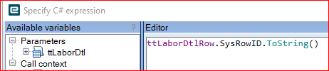

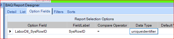

The Data Directive is set for if the method is called by user AB and labor qty of the changed row is greater than zero, then auto print. I tried to add it the sysrowid for an option in the report designer so I could use it in the print options, but its not showing up. Can you explain how I could use the SsysRowID in this case?
@Will79 I don’t have any BAQ reports to use for this so I faked one up with your LaborLabel as the BAQ. I was able to add SysRowID as an option, but not a filter. In AutoPrint I set that to a string. I have no way to test if that will work
