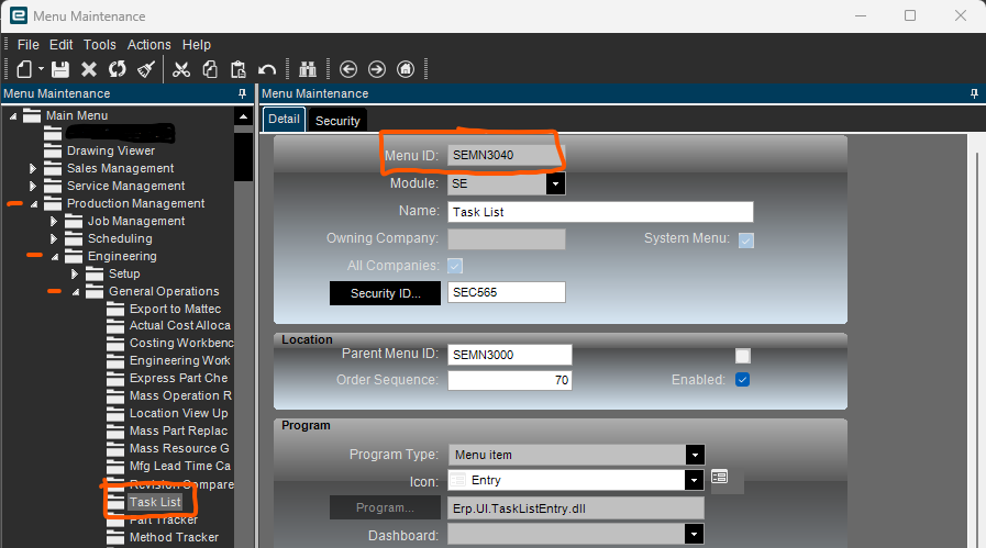

Find out the location of the “Task List” menu item. If you search for it, it should give you the path.
You will need this to figure out the Menu ID for “Task List”.
To get the Menu ID, go into “Menu Maintenance” (can search for it as well).

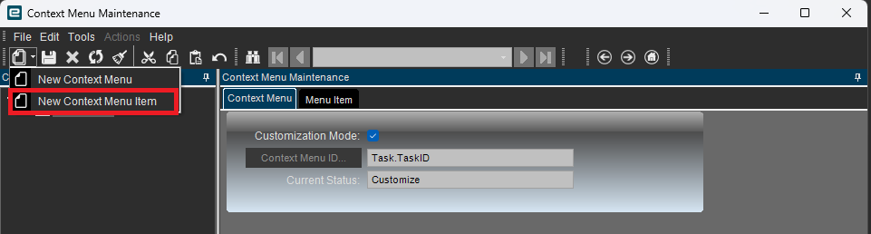

Then go to “Context Menu Maintenance” and create or search for “Task.TaskID” or “TaskMast.TaskID”. If you have to create it, create it and then save the form. Then Create a new Context Menu Item.

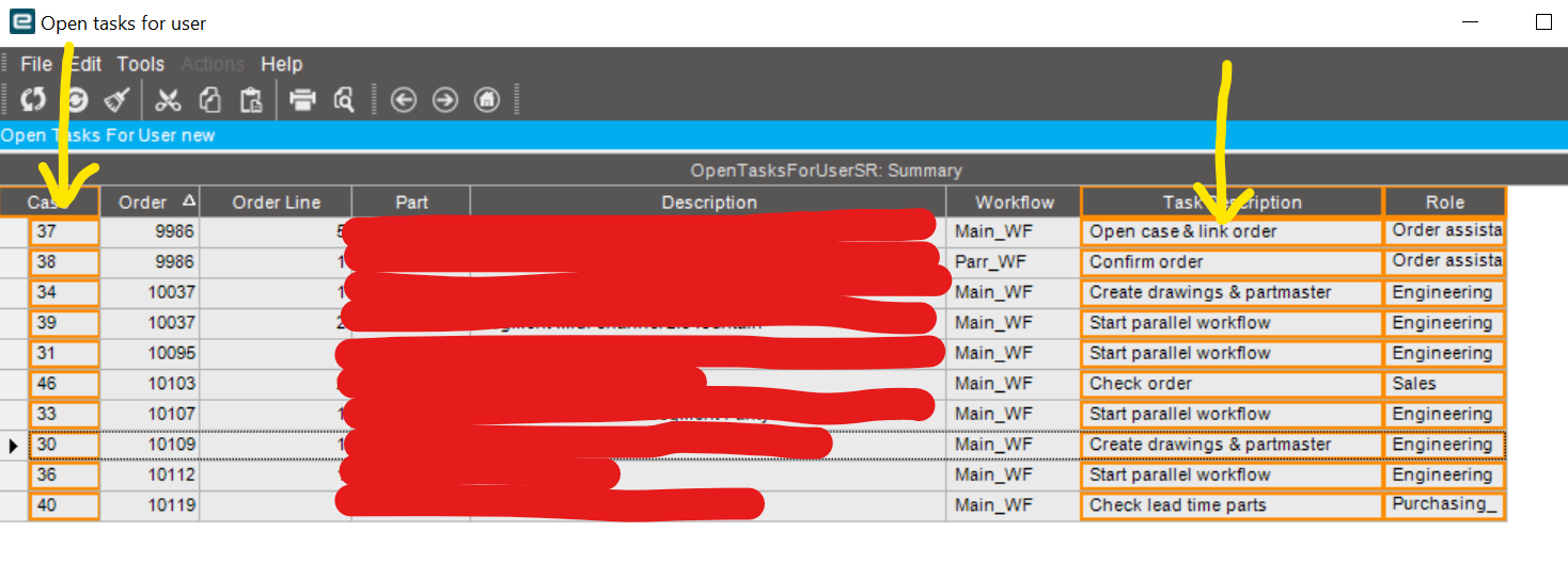

Thanks @masuphiber for your reply.
I was able to launch Task List from a BAQ column but it was empty.
I still needed to select the right Workforce and corresponding task.
By right clicking on Case, Case entry opens and I can complete a task there.
I wanted to know if by right clicking Task Description (or Task sequence/ ID etc.), Task List can be opened with the selected task.
