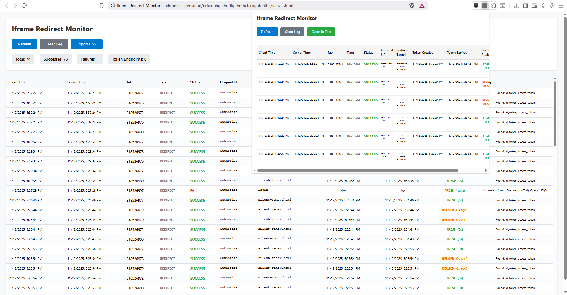

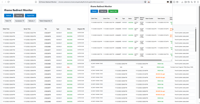

Claude n I made an IFrame Redirect Monitor browser extension which compiles all silent renewals and analyzes tokens and timestamps for all tabs. Works good. May work for the AAD /token renewal endpoint as well but havn’t proven that.
Still looking for patterns. Oddly (perhaps coincidence?) appears some tabs are synced and other not.
Iframe-browser-extension.zip (21.3 KB)

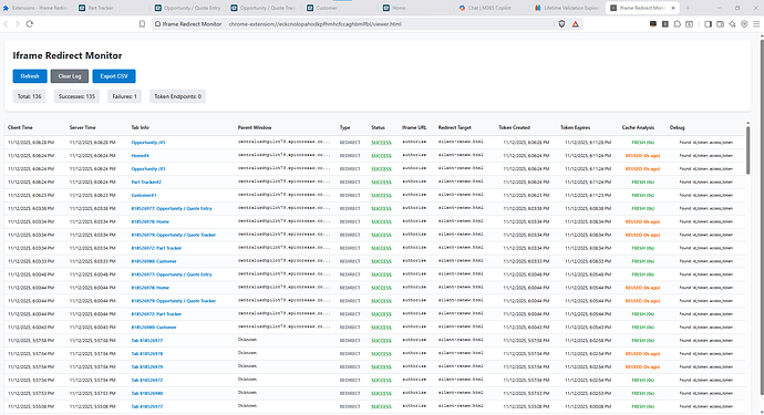

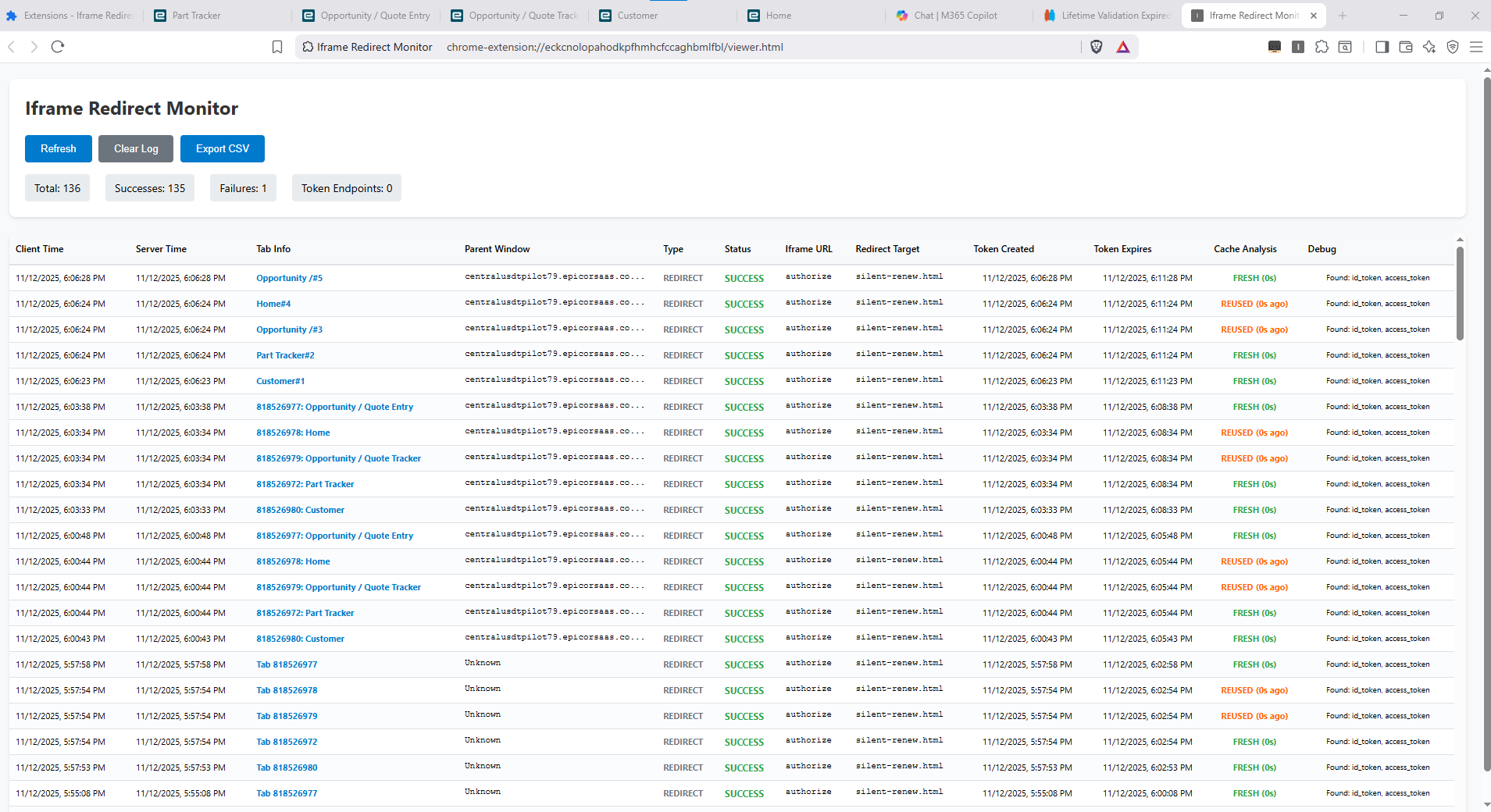

Is it possible to catch initial tab window.location before it is redirected to IDP?
oh and it looks very cool :+1:
Lemme ask Claude and I’ll tell him you like his style. :wink:
Um wait, first, what url location are you refering to?
The window.location that contains the iframe which loads Idp /authorize? sure.
I did not look how you did this. but iframe should be created by some window. What is the address of this window.
There’s an Iframe on every window but yes can capture parent location.
There, grabbed the tab titles as well.
iframe-browser-extension.zip (22.6 KB)
