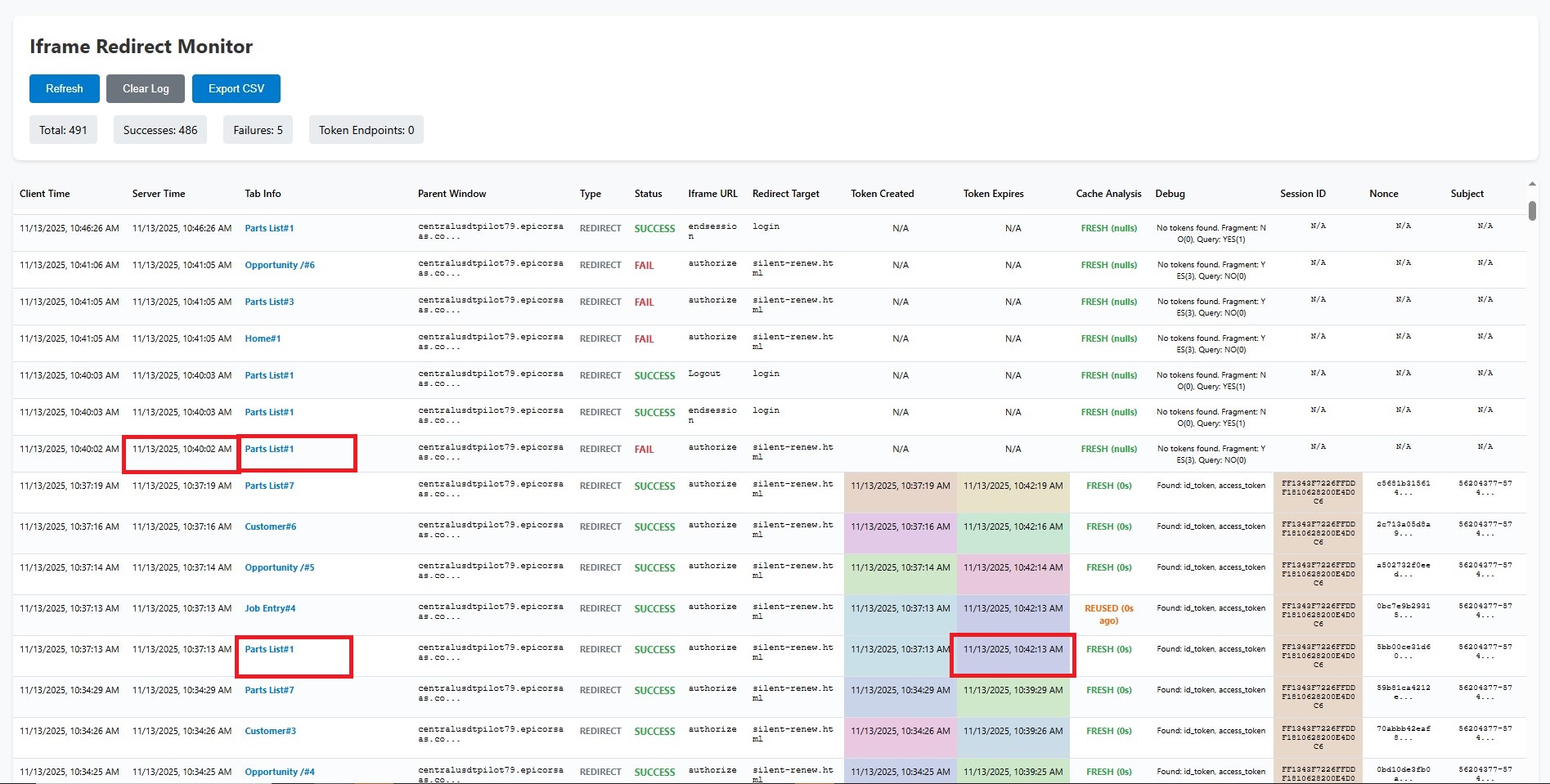

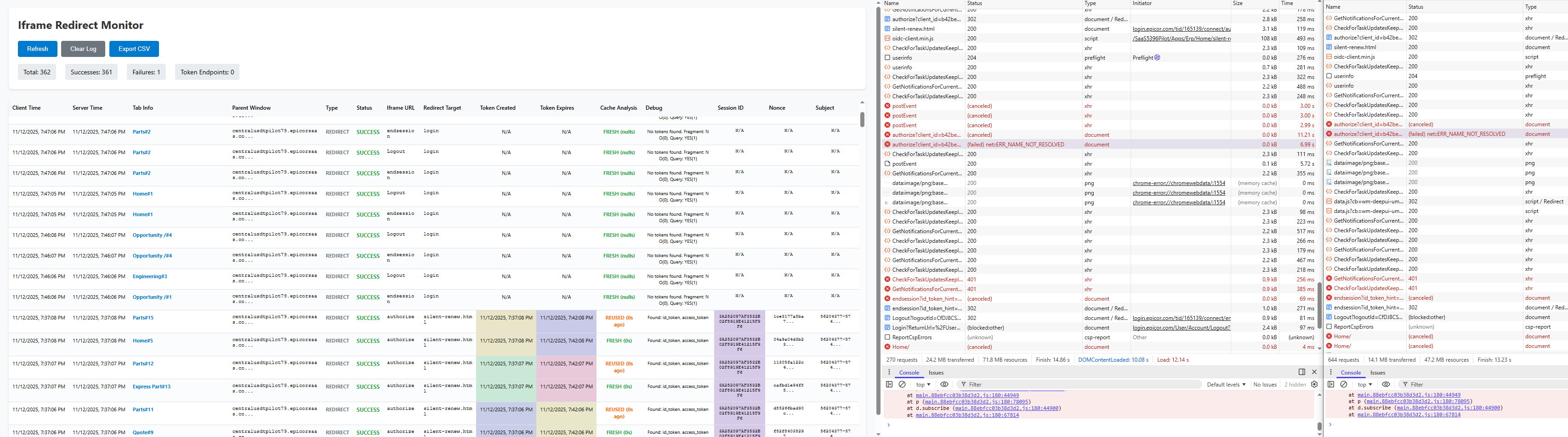

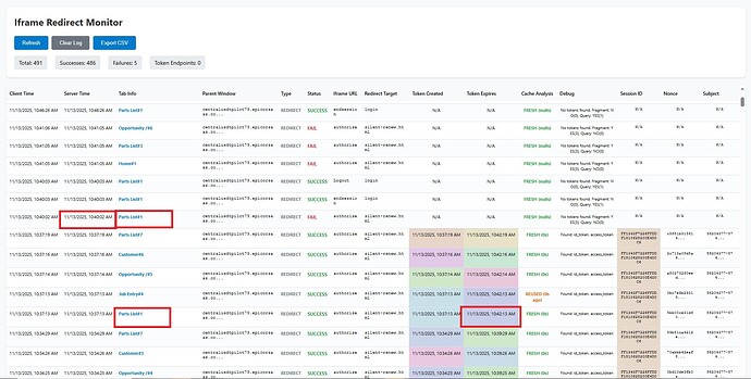

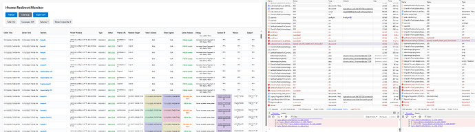

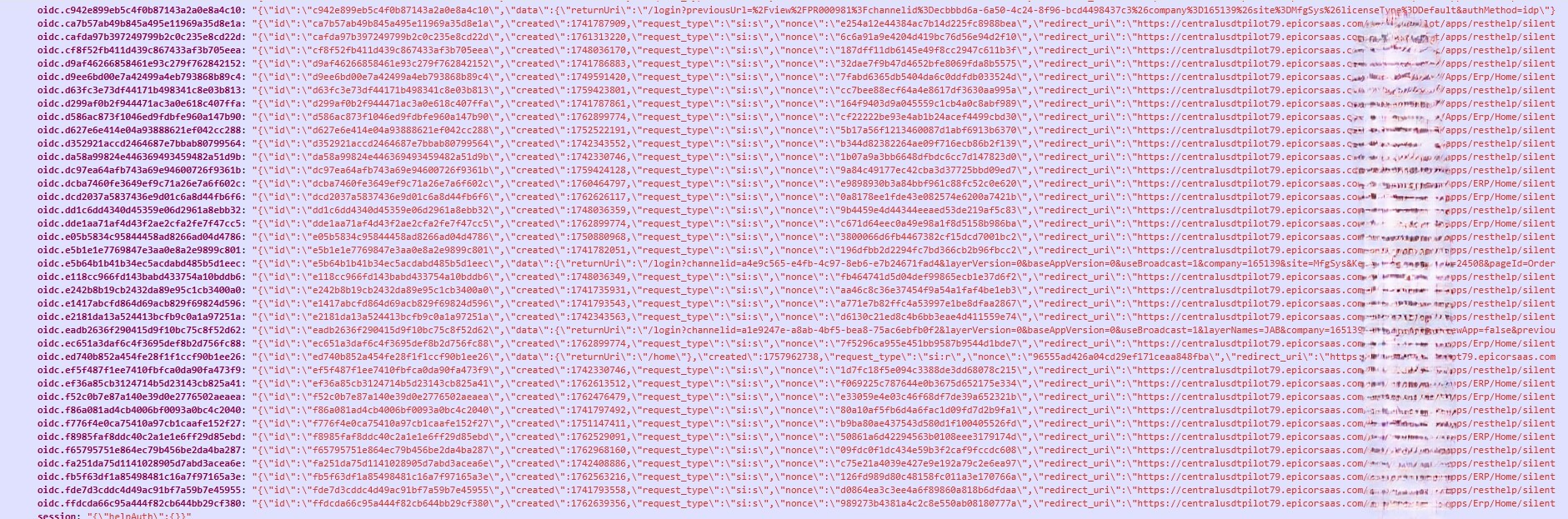

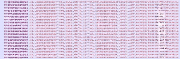

Did notice some old orphaned oidc sessionIds in my localStorage. Looks like /RestHelp is the culprit there. Which coinsides with another suspicion that /RestHelp never silently renews properly.
but yeah IdP cookies are probably not accessible via javascript (http-only let’s hope)
I’ll run this again today but I havn’t captured a silent refresh failure since increasing the session timeout in IdP. but it is still failing randomly.
I’m positive we will figure something out if we keep iterating on how to log this and how to work around what we can’t log, we’ll come up with a proof, especially if we have @Olga’s help and your level of custom tooling/coding.
Maybe this is just a random page timeout..
@jbooker, your hypothesis is that these other tabs (and their interactions with the token refresh or page timeouts, or whatever) are playing some part in the refresh not happening appropriately, right? In other words, page timeouts, token refreshes, etc. aside, we should not be seeing this error when we are clearly active on another tab. right?
All i know is it seems to silent refresh fine when I walk away. But the problem bites me often when I’m working, I’m always working in many tabs, and one tab failure seems to dump them all. That’s why I went down the many-tabs rabbit hole. Clean ERP tabs (/Home) are working pretty well so far, so now I wonder if the pattern might be related to other pages like AppStudio, RestHelp, etc. That wouldn’t explain all cases of refresh failure cuz it’s definaelty affecting others who never go there, but IDK. Just pulling straws.
