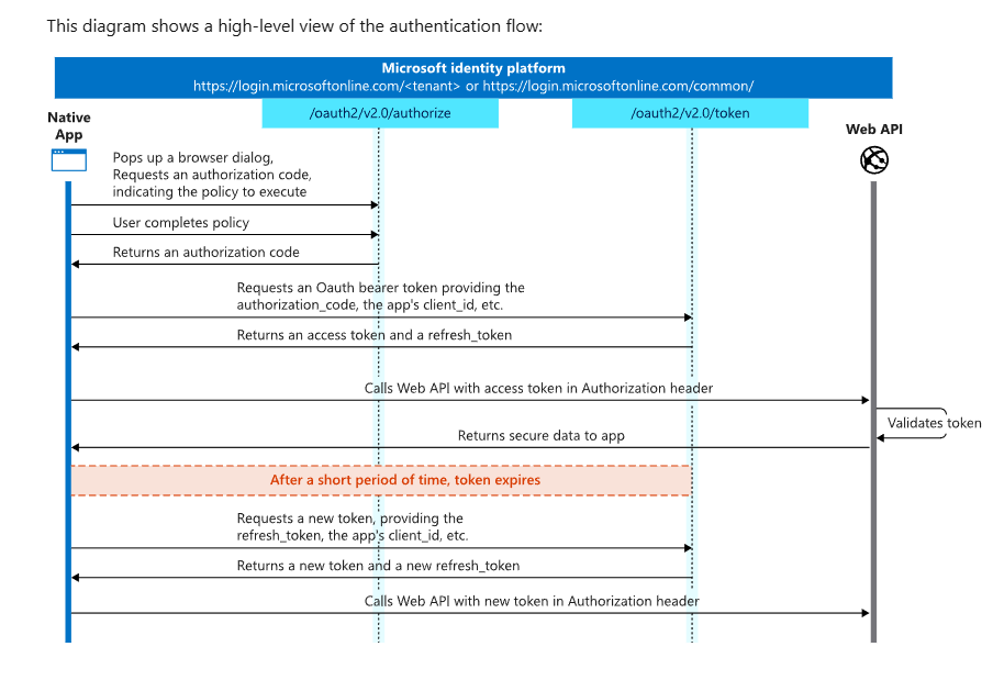

AAD is a bit trickier to log as both @mbayley and @Olga have mentioned previously because the access token lifetime is set in AAD and is random variable (60-90min), AFAIR. So you have to wait a random long time to get results. With IdP in the middle, we can set access to short time and await results on a regular cadence. Maybe you could tweak your AppReg if separate from Live on your test env but IDK (?)
But let me get this straight, when access lifetime runs out, I need to re-authenticate by going through the home screen again right?
No. access token is short (minutes, 60-90min typically). Before that the app should silently refresh using refresh token (long, hours or days). Whats failing is the part labeled ā€˜After a short period of time,’ You should only need to reauth if this refresh fails otherwise never.
Thanks for breaking that down again. That’s where I was getting lost about what we should and shouldn’t be experiencing given how AAD tokens work.

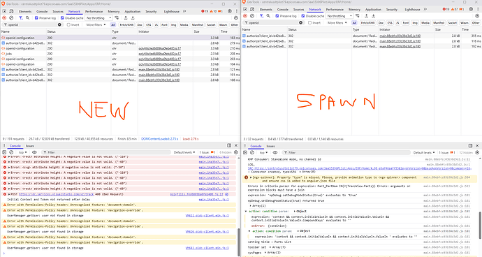

I see that your failing call precedes with call to /openid-configuration.
I wonder why.
Maybe you dashboard should show all calls to login.epicor.com too.
AFAIcantell, new tabs call /openid-configuration but spawned tabs don’t (?)
Meaning brand new tab > navigate home does so. yet duplicate-tab or open-in-new-tab or context-menu-spawn does not do so. :person_shrugging:

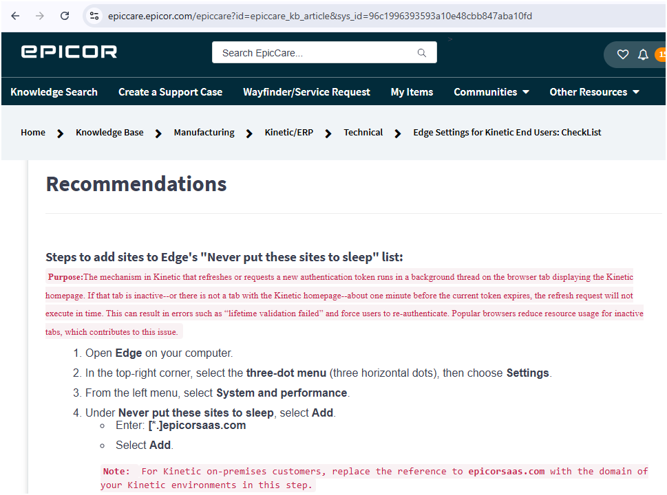

Some KBs Epicor have created:
Edge Settings for Kinetic End Users: CheckList
Chrome Settings for Kinetic End Users: CheckList

I think why it worked for me is that I did what this says, telling Edge which site(s) to ā€œnever put… to sleep.ā€

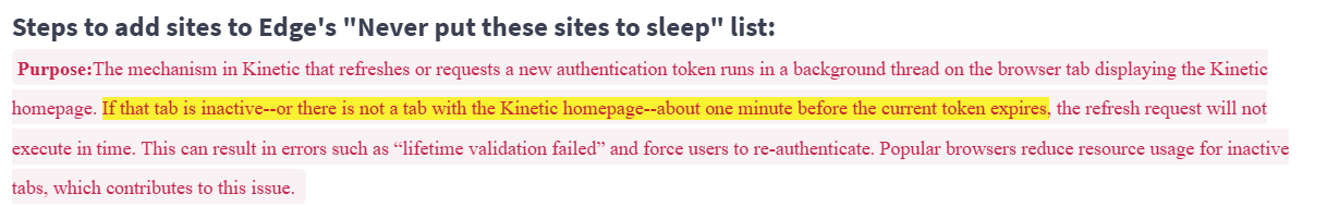

I’m curious as to why the refresh authentication token has been designed to check if the tab is inactive for about one minute before the current token expires.

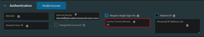

When historically, the License Timeout Minutes value for inactivity commonly 15 minutes or longer. Users were not logged out, only the licence was released.
Poorly worded article. It’s not one minute of inactivity, it refreshes about one minute before expiration. So if your token is one hour, it refreshes at around 58-59 min. This is common practice to avoid expiring due to client server clock diffs, etc
No idea whether how token relates to license release.
This is correct - the article is a little confusing, but it’s saying that we auto-renew tokens about 1 minute before expiration.
