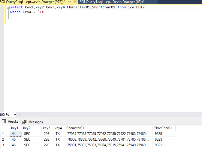

I have a function created to do a look up on what regional sales person we have in specific zip code. The zip codes are listed in a comma separated list in Character01 filed on my ud Table. I have key2 being my country code and key3 being my state. I have three reps that cover a state like TX.
Questions is how do i lookup the zip code in character01 and see if it is there for the correct regional sales person. Or should this be done with dynamic BAQ or anther tool.

I think that you can use the SPLIT command combined with the contains… this way you dont have to worry about the commas, because the split will automatically take care of it. Something like this (I have not verified).
