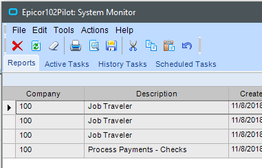

Here is a screenshot of 10.2.300.3 and the Reports tab is still there.
Maybe he meant 10.3.300 …
