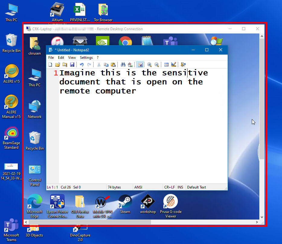

What if I open a remote desktop to another computer, and view the doc on the remote computer. Could I do a screenshot of my local computer, capturing the window containing the “secured” document? Like in the following, wher the red box shows the remote computers desktop.

I wasn’t going to put screenshot in the list but I did because it is enforced on mobile devices. The point isn’t about 100% prevention but to slow theft down.
Insider risks are tough. With M365, you can do some risk assessments (machine learning) to see that a person is downloading more than usual or in a Document Library that they are not usually in. While you cannot prevent all risks, you have far more tools to use in the cloud than you will on prem - at the minimum, you’ll need the cloud tools to help protect your on prem resources.
If you use Windows Virtual Desktop, Microsoft recently announced the ability to prevent the RDP screenshot. Not sure about other RDP hosts though…
