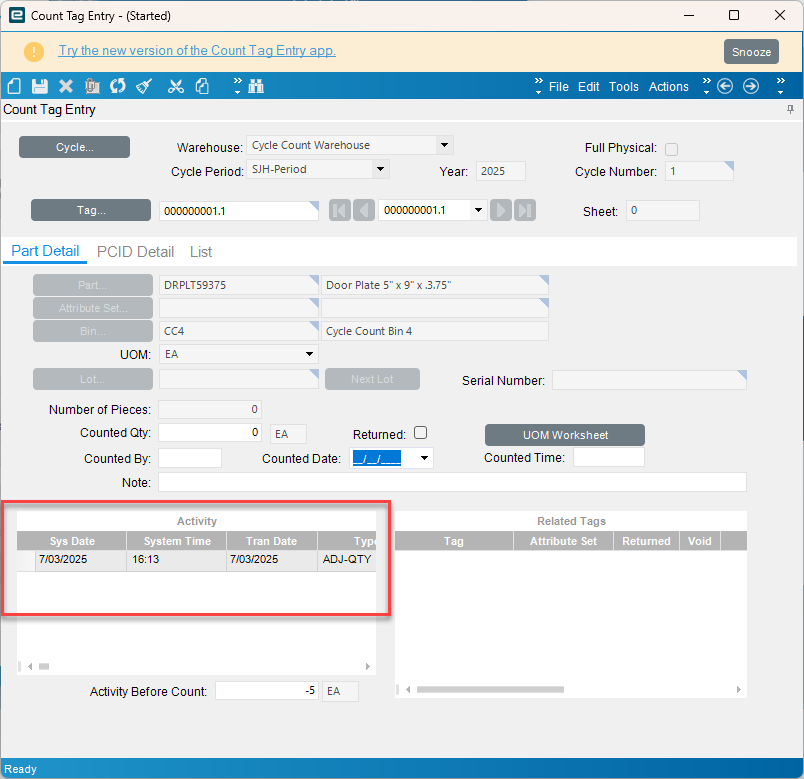

During a cycle count of full physical stock take an inventory snapshot is taken. When the post occurs any qty changes outside the count are recorded and combined into the posting to calculate things correctly.
Here is a screenshot of the count entry screen and here I have performed a qty adjustment after I started the count, so you can see the activity that has occurred.
when the posting occurs it takes into account the snapshot qty which in this instance was 100, and the counted qty which is 95, sees that there was an activity of -5 so ignores the count variance of 5, so the posted cycle count variance would be the cost of 0…
Hope that makes sense.
