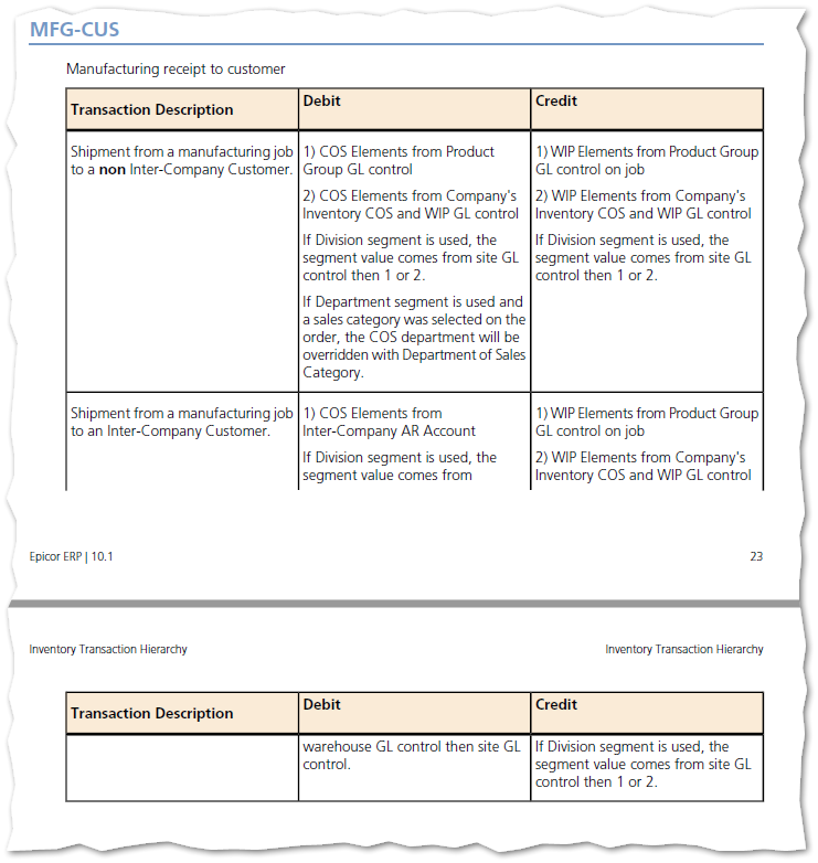

The “Epicor ERP Inventory Transactions Technical Reference Guide” explains what accounts each tran type should hit.
Some examples for the various contexts of a MFG-CUS part tran:
Post Material Cost to WIP and AR Clearing Accounts
Executed for MFG-CUS transaction when AR Clearing Account is used. Posts Material Cost amount to WIP and AR Clearing accounts. Debit and Credit accounts depend on sign of the Material Cost amount.
Post Material Cost to WIP and COS Accounts
Executed for MFG-CUS transaction when AR Clearing Account is not used. Posts Material Cost amount to WIP and COS accounts. Debit and Credit accounts depend on sign of the Material Cost amount.
And there’s 10 more of these … You get the picture.
The “Epicor ERP Inventory Transaction Hierarchy” document shows you the order in how the GL accts are determined for the tran type

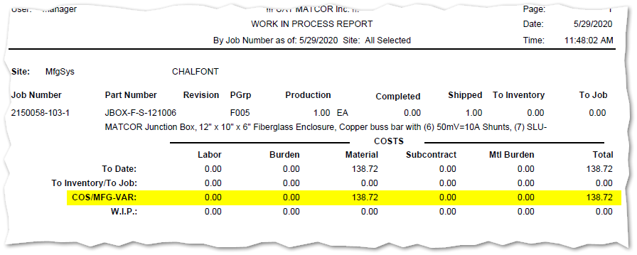

I run the WIP Report with settings and filter:
  • Include Jobs not Closed = TRUE
  • Closed range: blank to 5/29/2020
  • Tran range: blank to 5/29/2020
  • Filters: Job 2150058-103-1, All Parts, All PrdGrps, All Sites
  • WIP Cleared Status: Both
  • Inc Phantom = TRUE, Inc Non-Potsed= TRUE
and see:
When I run the WIP RECON for just this job, I see:
Acct’s 1127-00-01 (AR Clearing) and 1152-00-01 (WIP), both net to zero. And the original cost from 1151-00-01 (Raw Mtl Inv) exactly matches the amount in 6379-00-01. This is exactly how I expect the material costs of a Build to Order job to flow.
So why does the WIP report show a value in the “COS/MFG-VAR” line?
Does it not mean that there is $138.72 of cost that needs to create a variance transaction?
