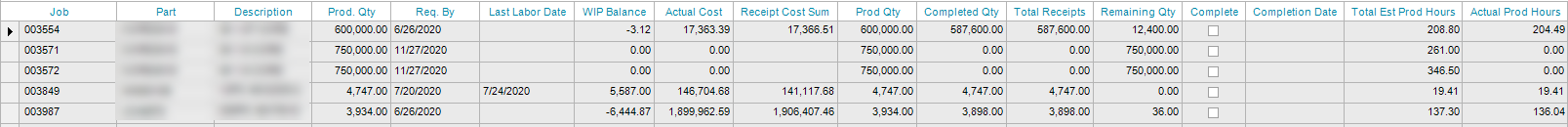

See attached query for some basic job data. At least it can be a starting point for you and might need tweaking. Be sure to compare it back to your WIP report to make sure it is accurate for you.
For the WIP balance I am just taking the actual job cost and subtracting the extended cost of the receipts/shipments. If you have job activities including adjustments, non-conformance entries, etc. this probably need to be adjusted accordingly. Comparing it to your existing WIP report will let you know how accurate it will be in your environment. You will also need to add a filter for closed jobs. Currently, this shows all non-closed jobs.

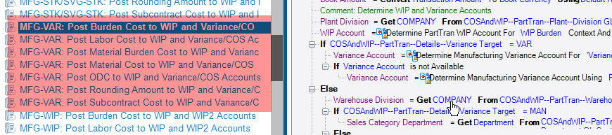

It is because in this floating inventory cost model they are all generated on-the-fly via posting rules during the INV/WIP Reconciliation process. You can examine these to see how they are generated in the COSandWIP GL Transaction Type Maintenance.
It will generate them all during the process that runs and let you post the results to the GL but they are not sitting out there in a table.
