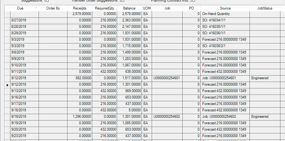

I think we are on the same page. We have truly been fighting this same monster for quite some time. Let me try a screen shot here.
So, here’s our Time Phase. We have unfirm suggestions, as you can see. Although the Due Date on this suggestion shows 9/12, it’s deceptive. You have to look at the job.
By going to Job Tracker, we can see that this job actually has a final operation date for 9/6/2019. The Due date is relative to when the parts should leave the building - the last possible second. The actual Final Operation date is occurring 5 business days prior to when those parts are scheduled to leave the building.
