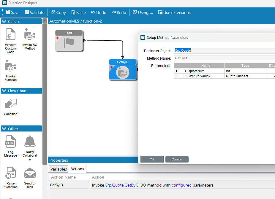

You’re definitely on the right track here. BPMs are executed based on when the Epicor Business Object methods are called (Method Directives) or when specific tables are updated (Data Directives), so if you’re wanting more user control, a function is probably the way to go.
I tend to use custom code functions, but I think you could probably do this one with widgets. I would take a look at the Epicor documentation for Functions (Open up Functions Maintenance, click Help > Application Help).
For something like this, the “Update Table by Query” widget would probably do the job. In your function, you would pass in the quote number from the entry form that your user is working in as a Request Parameter (set in Function > Signature tab).
You would then use the “Invoke BO Method” to call the “Quote.GetByID” method, which will give you the Quote Tableset for the quote you’re working with. The Tableset is a collection temporary tables (QuoteHed, QuoteDtl, QuoteAsm, etc) that the Business Object uses for updating data.
Next, you can use the Update Table by Query widget to update your quote lines to engineered. If you’ve used the BAQ editor, it’s very similar. You can add the QuoteDtl table, then bind the values to the query results or specified expressions. That last part is the key, because it will let you set the QuoteDtl.Engineered field to true. You’ll also need to set the QuoteDtl.RowMod field to "U", which tells the Business Object that row needs to be Updated (U = Updated, A = Added, D = Deleted).
Then the last thing to do would be to invoke the BO Method “Quote.Update”, which will then save / update all the tables with populated “RowMod” fields.
If you’d prefer to use custom C# code, that can be done too. Personally, I find using code preferable to using widgets, but that’s just me. The code below essentially does the exact same thing as the widgets above, using the same BO Methods and everything:

Correct me if I’m wrong, but If you do the widgets, update by query will just change the field in the dataset, but I don’t believe it’s actually going to call the update method. And I don’t know if you can update more than one row at a time. (Each BO is a little different and some allow it, but most don’t). So if you’re going to use widgets, you’re going to have a set up a loop and another widget for update, right?
Edit: you did say something about update… I just looked at the picture. (oops). But the question about the loop still stands.
I should probably bold the part just below those screencaps about adding the Invoke BO Method “Update”. It does get lost since I drop the code in there just below it.
That might be the case. In the code I always put the Update inside the loop, I had thought Update Table by Query allowed multiple row updates. I don’t use widgets very often, so there’s a good chance I’m wrong on that. If that’s the case, there’s definitely some extra widget work that needs to be done.
Me too. And the widget will update the fields. But in the UI, whenever you change lines, the system does a save, so functionally, you can never have more than one row change at a time. Because of that, most BOs only take one change at a time. It’s one of the reasons I don’t like widgets. There are many reasons to need to loop, and it’s really challenging to do with the widgets.
