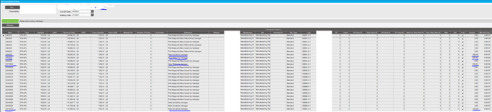

Hey Epi Gurus,
I have an issue where I have successfully written a BPM to Mass Issue & Mass Return job materials based on a trigger (Job Released / Un Released). All of the transactions show up how I would expect in Part Transaction History Tracker except for the following issues:
  1. The “Running Total” behaves unexpectedly, and seems to always add the Qty to the running total no matter what, even increasing the “running total” for PAST transactions in the tracker upon refresh…
  2. Similar to the Running Total issue, the On Hand Qty behaves the same as the running total where it seems to only increase or stay the same, and not go up and down equally for Issue/Return as expected.
  3. The “Amount” field on the part tran ($amt) shows “0.00” and never calculates the ExtCost for the STK-MTL transactions that are occuring via BPM code.
I am currently digging online and through tracelogs to try and find what field / parameter I am missing in the BO Method Calls in the BPM.

It’s hard to say from the screenshot and your descriptions alone.
I’m thinking we would need to see a combination of your BPM code and PartTran records to get the full picture.
Part Transaction History Tracker is driven off of PartTran data. As a starting point, you should probably review your PartTran records to compare those generated by your BPM vs those from manual Issue/Return commands.
Understood. I have begun first by looking at the PartTran entries as you’ve suggested, the only differences I see are:
  • “ExtCost” fields (not populated / =0.00 on my custom transactions versus the expected $amt on the base epicor transactions),

And the Part Tran Hist tracker (blue underline are the epi base issues/returns showing amount properly:
The Running Total quantities appear to be correct. For example, the most recent transaction: Start with 29,195.64… Issue 232.81 to a job from stock… you have 28,962.83 remaining.
As for the Extended Costs… I’m not sure yet but I would imagine there’s some missing method call or parameter.
I also should note that I learned that the Running Total field is calculated off the On Hand Qty so its really the effect on the OnHandQty that I am focused on, if I can fix that then the running total should follow correctly.
The running totals you are seeing are deceiving-- they ALL go up (including the PAST trans), so what you’re seeing now is like a couple 1,000 more than what it started with. Every time I Issue and Return as a test, the on hand qty goes up and the running total for ALL the trans goes up.

Got it, that’s hard to communicate in a screenshot.
Agreed- my apologies on not being more clear on that one!
That amount on the far right is the Qty * MtlUnitCost.
Right-- and for whatever reason it does not calculate for my BPM transactions even though both Qty and MtlUnitCost fields have positive values.

  <localTime>2/27/2023 10:33:27:8156844 AM</localTime>
  <threadID>1</threadID>
  <correlationId>ab6c97a2-6f2e-458e-9c7a-89e878e0a005</correlationId>
  <executionTime total="105" roundTrip="101" channel="0" bpm="0" bpmDataForm="0" other="4" />
  <retries>0</retries>
  <parameters>
    <parameter name="ds" type="Erp.BO.MassIssueInputDataSet">
      <MassIssueInputDataSet xmlns="http://www.epicor.com/Ice/300/BO/MassIssueToMfg/MassIssueInput" />
    </parameter>
    <parameter name="ipSysRowID" type="System.String"><![CDATA[a42f9b8d-4439-45b2-ae44-15d48538de59]]></parameter>
    <parameter name="pcMessage" type="System.String"><![CDATA[]]></parameter>
  </parameters>
  <paramDataSetChanges>
    <paramDataSet name="ds" useDataSetNbr="0">
      <changedValue tableName="MassIssueInput" rowState="Modified" rowNum="0" colName="IncludeSubassemblies"><![CDATA[True]]></changedValue>
      <changedValue tableName="MassIssueInput" rowState="Modified" rowNum="0" colName="RowMod"><![CDATA[U]]></changedValue>
    </paramDataSet>
  </paramDataSetChanges>
</tracePacket>
I thought that was supposed to be the job sysrowid, can’t remember.
on a phone now lol
