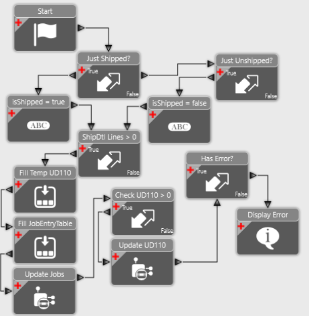

Here is the CustShip.UpdateMaster Method Directive:
The method validates the ship state of the pack (just shipped/just unshipped). Uses it to set a flip, checks that there are valid lines on the shipment. Populates the UD110. Populates a job entry table, ensures that the jobs are set as engineered and released. Ensures UD110 has records, posts them, and then displays a message if there was any error.

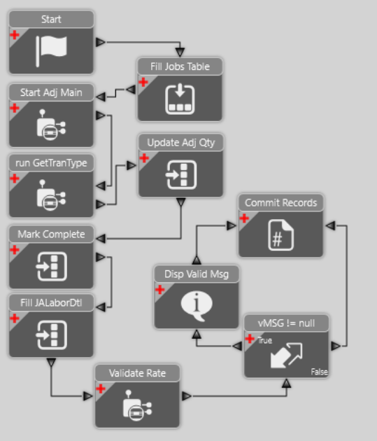

Here is the post processing method directive on UD110.UpdateExt
It starts by populating the jobs that were just submitted into the jobs table. Then the StartAdjusments and GetAvailTranDocTypes methods of JobAdjustment are run. The adjustment quantity is then populated from the UD110 entries to the job adjustment table. Jobs are marked complete if line was marked complete. The JALabourDtl table is populated. The Validate rate method is run, the output message is checked if it is not null, displayed if it. Lastly these records are posted using the below code.
var jobAdj = Ice.Assemblies.ServiceRenderer.GetService<Erp.Contracts.JobAdjustmentSvcContract>(Db);
foreach (var job in (JobAdjustTable.Jobs)){
jobAdj.CommitLaborAdj(ref JobAdjustTable);
Again this is really a hack and I do believe that the external method route would be better (or perhaps the issue will eventually get resolved and you won’t have to work around) but it does work.
