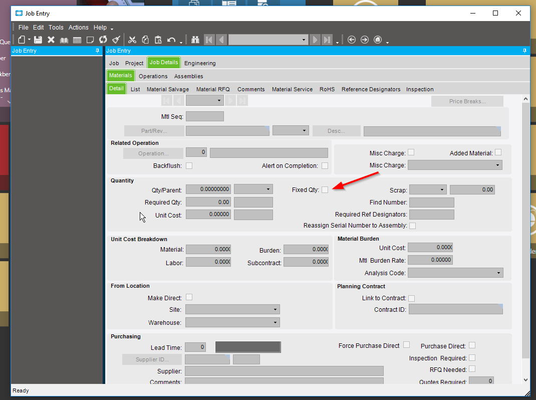

Sorry that you are having to dumb this down. I thought when something is back flushed, it is looking at qty per parent, and issuing it to the job. So if the job was for 100 pieces, qty/parent was 1 per piece, then when the operation is completed, it would issue 100 of that material? If I do it your way, what qty is it using?
It is normally, but, you can set materials to fixed qty, and it won’t multiply them. See the screen shot below. DB field JobMtl.FixedQty
edit: I should say that you should probably double check that though. I know that fixed quantity has affected purchase suggestions on purchase direct parts, but I haven’t followed through with the back flushing to make sure it follows the same rules, because it’s not often we have that specific combination here. I assume it works that way.
ah ha, great. I will give that a shot, thanks for the help!
