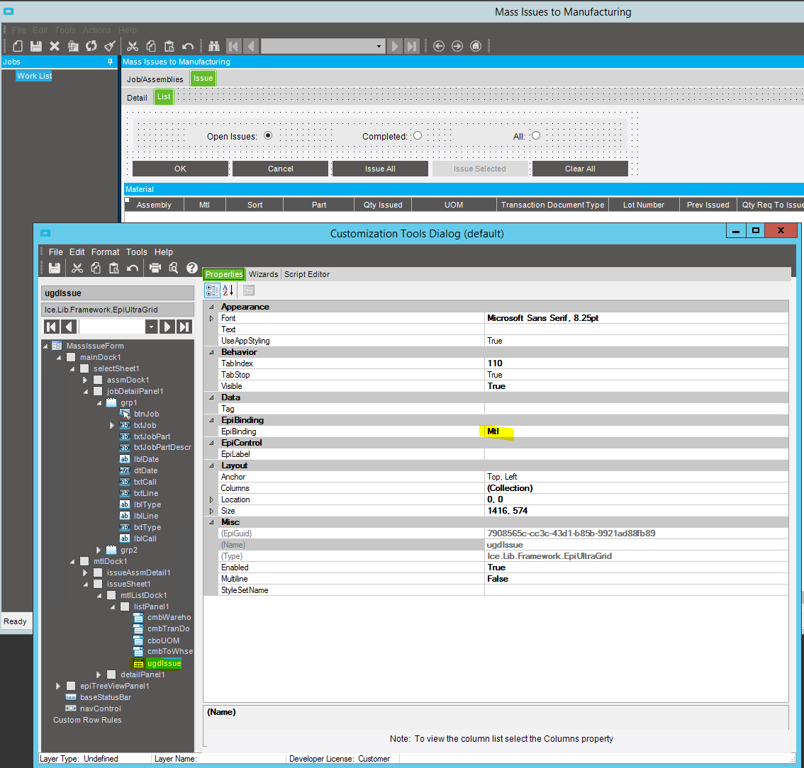

Hi everybody, I need a way to add fields from the JobAsmbl table to the Issue-List grid in the Mass Issues to Manufacturing module. We key in a job, check “Include Subassembles,” hit “Issue,” then the relevant data populates in the Issue-List window. We want to being in 6 additional columns, but 3 are user-defined. I believe the first 3 can be simply un-hidden in the customization settings, but how do we bring in the 3 user-defined fields?
What’s the Binding of that Grid?
Assm
Got it, you are going to have to either replace that grid or manually look up what you need in a customization. There are a few entries on here on how to do these (different ways)

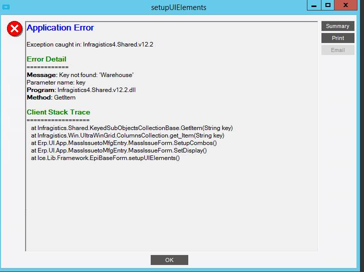

Also Jose, I attempted the technique you explained in this thread: Grid Property Changed - #12 by josecgomez, but it wasn’t successful…we get this error shown in the image:
I’m not sure what its talking about regarding “Warehouse” but that error generally means there’s a wrong binding somewhere.

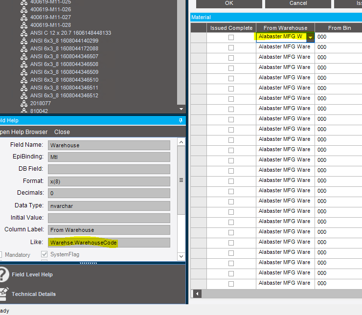

Is there a “Warehouse” column in your BAQ?
No, but I have “Warehse_WarehouseCode” in the BAQ, since that’s what the module appears to reference in the Field Help.

So as a follow up, I discovered another method to add the necessary columns directly to the Mtl EpiBinding…see code:
private void edvMtl_EpiViewNotification(EpiDataView view, EpiNotifyArgs args)
// view.dataView[args.Row]["FieldName"]
// args.Row, args.Column, args.Sender, args.NotifyType
// NotifyType.Initialize, NotifyType.AddRow, NotifyType.DeleteRow, NotifyType.InitLastView, NotifyType.InitAndResetTreeNodes
if ((args.NotifyType == EpiTransaction.NotifyType.Initialize))
if ((args.Row > -1))
if (!(edvMtl.dataView.Table.Columns.Contains("Width")))
edvMtl.dataView.Table.Columns.Add(new DataColumn("Width"));
edvMtl.dataView.Table.Columns["Width"].ExtendedProperties["ReadOnly"] = true;
if (!(edvMtl.dataView.Table.Columns.Contains("Length")))
edvMtl.dataView.Table.Columns.Add(new DataColumn("Length"));
edvMtl.dataView.Table.Columns["Length"].ExtendedProperties["ReadOnly"] = true;
if (!(edvMtl.dataView.Table.Columns.Contains("Thickness")))
edvMtl.dataView.Table.Columns.Add(new DataColumn("Thickness"));
edvMtl.dataView.Table.Columns["Thickness"].ExtendedProperties["ReadOnly"] = true;
Problem now is, how to populate the columns? There is data in the JobAsmbl table, can I link it through the Data Tools, or would it have to be coded directly also? Thanks for all your help so far!
Sure that ads the columns, then you have to find the information (usually a BAQ or an Adapter) to do the lookup then you loop through those results and update each column in your data view.
I would suggest a BAQ that contains the information you want, then run the BAQ to get the results
