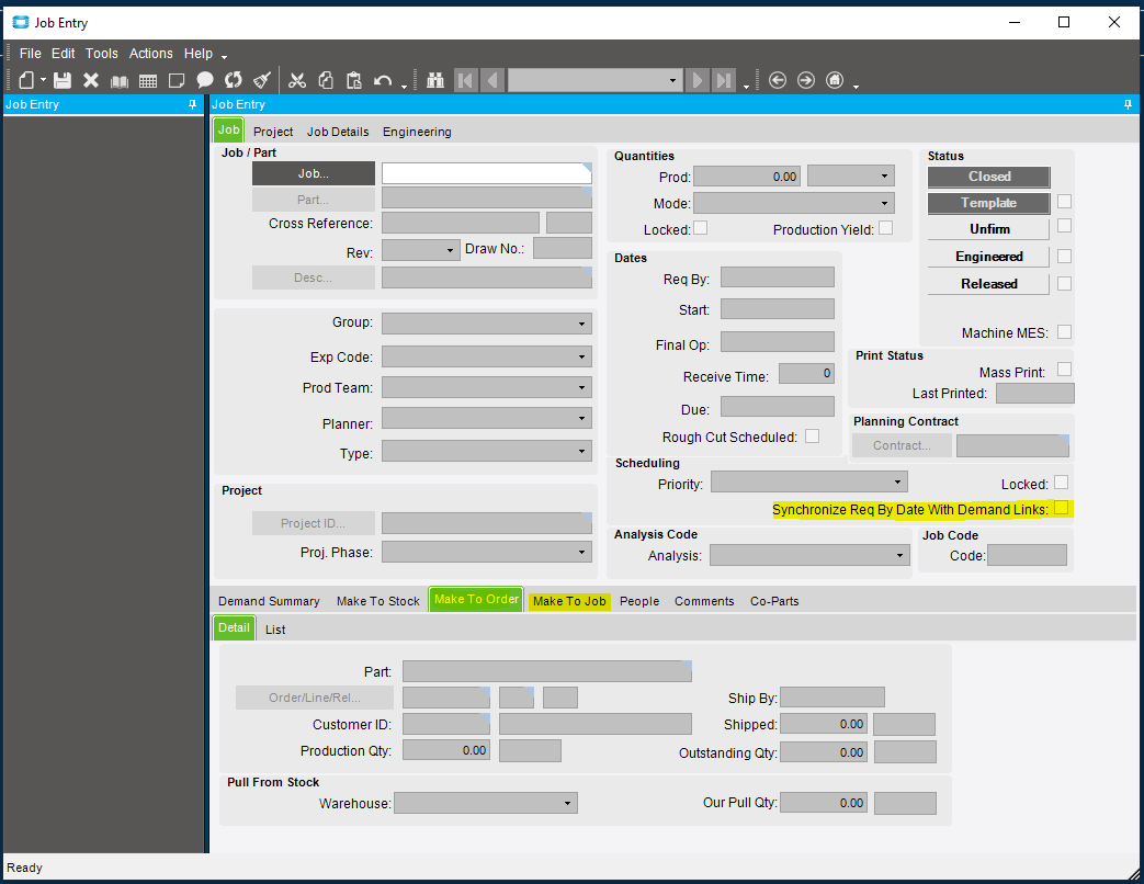

my best guess is that you Making to Order or Making to Job, thereby try to delete these JobProd linked records first, try it manually first to verify the concept, if this is what stopping you then you may need to DMT to delete these records first. then DMT to delete the JobHead records.

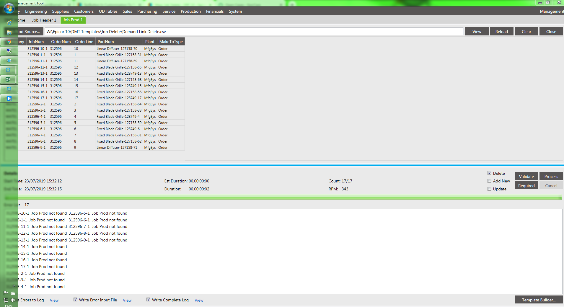

Thanks @A.Baeisa, we do make everything to order. I am able to delete the demand link manually but when I try to use the DMT I get the message Job Prod not found for all the jobs. I looked in job entry and the links are there

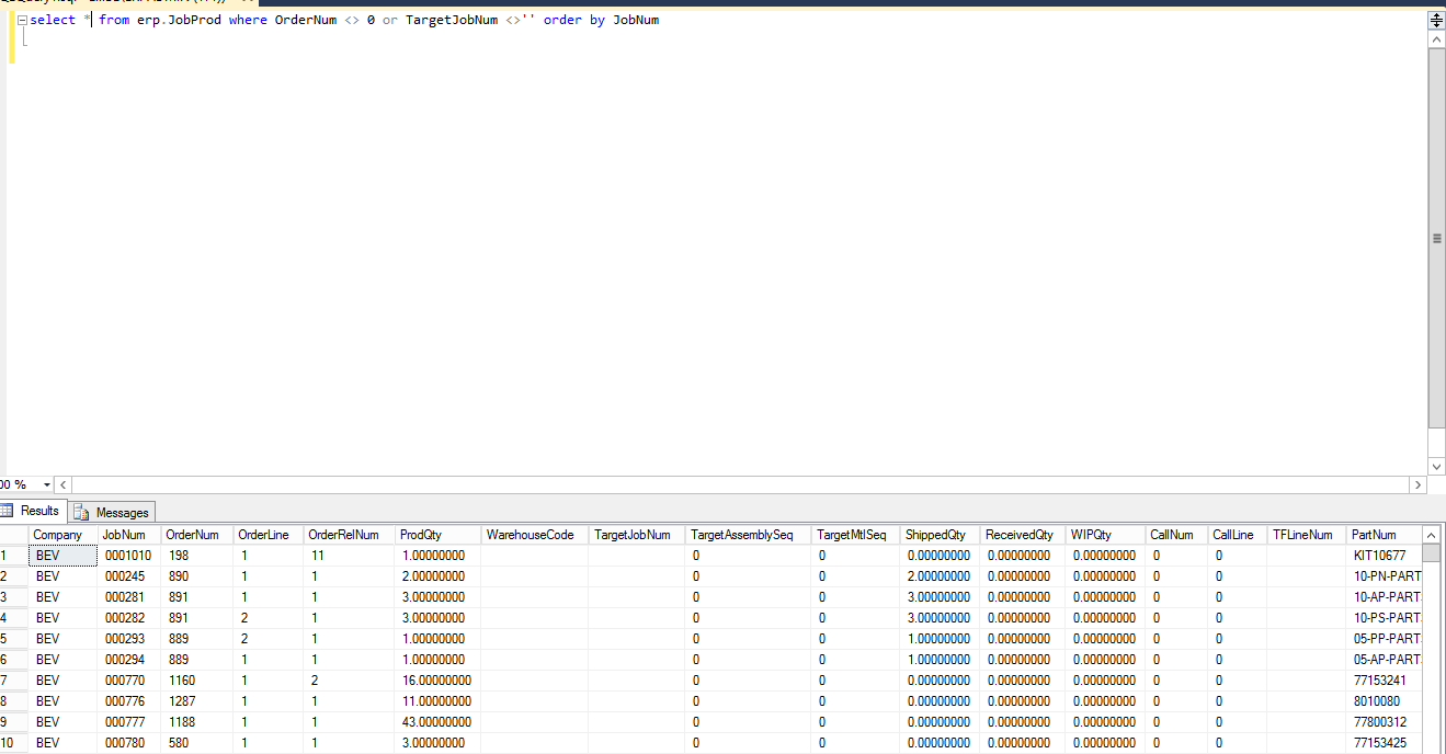

SQL your data for one example ONLY, also try and change MakeToType to [MakeToOrder], add OrderRelNum as well

Hi @A.Baeisa, using ‘MAKETOORDER’ solved the problem. I have just deleted over a thousand jobs from thirteen different sales orders in about thirty minutes! I would still like to go down the BPM route eventually or customisation may be to make the process even slicker. This really got me out of a hole for now though so thank you very much for all the help.
