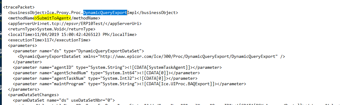

In V8, I created a BAQ and scheduled a reoccurring BAQ export. Then I made a BPM that triggered when the BAQExport ran.
But E10 does not have BPMs for BAQExport

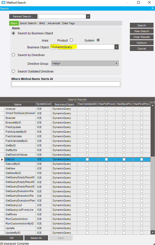

Your easiest alternative is to schedule a UBAQ (updatable BAQ export) and put your code in the GetList method of this BAQ.

I can’t seem to get the alert to work using a directive on the Ubaq’s GetList method. I have managed to get it to work using a Data Directive on the SysTaskLog table. This is something that will be scheduled to run out of office hours but is there any reason I shouldn’t assign the directive here? My boss is still looking into the process scheduler.

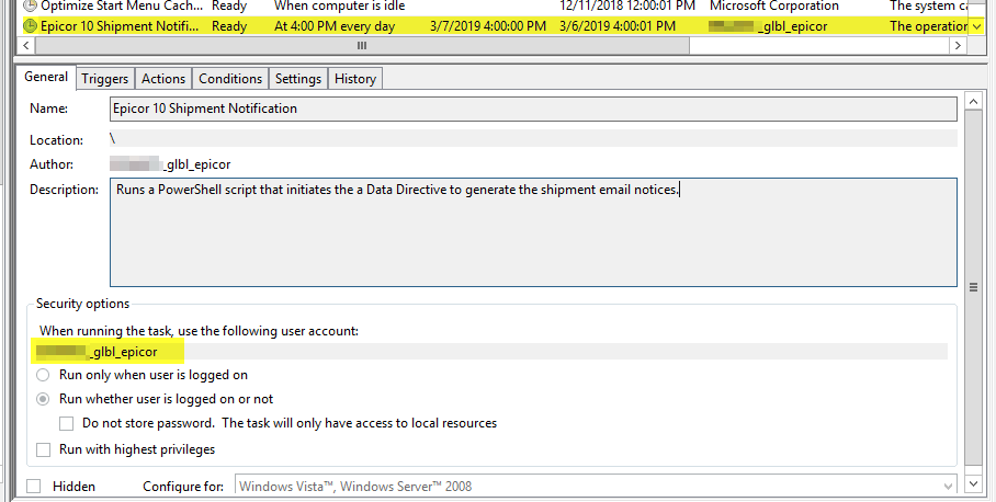

To avoid the whole risk associated with messing with SysTask, BAQ export call variability by version, or buying the third party software, I’ve started using a user code type called AUTOPROC, then placing a directive on the user code update that runs your custom code if the user code modified is your certain code (e.g. “AutoShipEmail”) and LongDesc is updated (to the current datetime or something). Then, you can call this update through whatever you want: REST, DMT, PowerShell DMT, and the code can be static and the meat and potatoes can be stored in the BPM. This does have the external dependency of the trigger and execution of the simple user code update; I am doing this through PowerShell DMT on a windows task schedule, which is easy enough and requires no SQL permissions.
