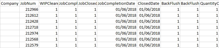

Just as a reference to the poor sod in the future that will be puzzled by the “Not a Valid Job Number” error when trying to mass close jobs through DMT, below is my magic column sequence. I fiddled for quite a while to make it work…
We are multi site, and usually I have a “Plant” column, but for this time it didn’t work. I am not sure why the column sequence works one time, and breaks other times. If it isn’t the DMT version, then it must be either the moon phase or the way I held my prayer beads while dancing and chanting around my workstation as I am trying to close 8K stale jobs. There were no Solar flares at the time I ran this, and my DMT version was 4.0.66.0.
