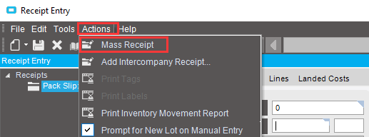

you can try below:
> New PackSlip without PONum, only enter Supplier ID and save;
> Then Go to Actions Mass Receipt, Now you can select multiple po,
Or you can quickly add PO via excel Copy & paste in Lines> List sheet, similarly, you cannot have PONum on your PackSlip Header.
Davie,
This worked perfectly. I had no idea you could do a mass receipt without entering a PO. Thank you

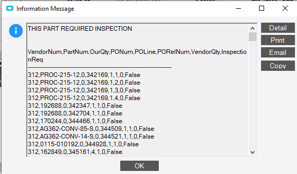

Why does this message pop up for each line that is selected?
Capture
Somebody wrote a BPM to display that message when a certain event triggers it. By the information displayed, it appears to be on PO Receipt Entry on Mass Receipt, but that might not be correct.
Check with whoever your system admin is to see who would have put that in.
Will do. Thanks! Once I know this is the case, I will mark solution.
