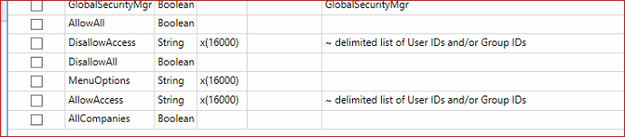

Do you recall if the Allow and Disallow lists need to be in the form of a tilde separated list (like SalesRepList)? If so, It looks like I’ll have to build a BAQ to export the MenuSec’s and then append “~READONLY” to each.
According to the template builder it is tilde delimited.

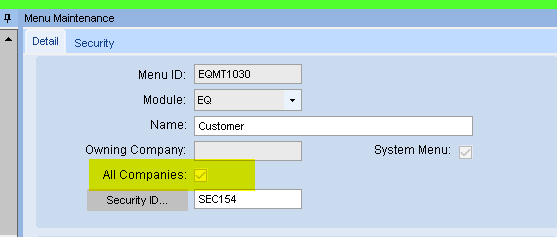

Yes, but remember that there’s a couple of connections going on.
  • Each menu item (including the “folders”) has a menu ID and a SecID
  • Several menus (folders or Items in them) can have the same SecID.
  • Changing the settings in the SecID (allowed or disalowed user lists) affects any menu that uses that SecID
So updating existing Sec properties (the allowed or dissallowed list) may apply to many menus that might not be obvious.
One last thing, I’m pretty sure that users that are Sec Managers can always access any menu regardles of SecID settings. This is good, as you can’t accidently lock yourself out of the security settings.
Thanks Calvin. I am looking to do this for an implementation so glad I have some room for Trial & Error as the software is not yet in use!
Just did a quick BAQ to view current entries and I can see nothing in the Company field for 99% or the rows. Can you limit menu security to certain companies?
I think so. We only have one company, so the Company field on menu maintenance is disabled for me.
