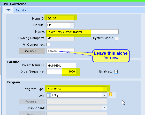

I’d do the following:
  1. Make a SecGroup QE_OT (Quote Entry / Order Tracker)
  2. Make the user a member of that group
  3. Create a new top level menu folder
  4. Create a new SecID
  5. Back on the Detail tab, change the Security ID to the one you just made
  6. In the new folder, ad a menu item for Quote Entry , selecting SEC_QE_OT as the Sec ID.
  7. Repeat #6 for the Order Tracker entry
At this point, the new top level menu folder “Quote Entry / Order Tracker” will only show for users of the QE_OT group. But the group member can still see all the other menus.
A lazy (and not really secure) thing to do would be to add the QE_OT group to the disallow list of the 1st level menu folders
That would make it so the restricted users could only see the QE OT folder. But they could still access the other programs using right click, “Open with …”.
To disable access to all of them, I’d use DMT to add the group QE_OT to the DisallowList of every every Security ID (except Sec ID SEC_QE_OT).
