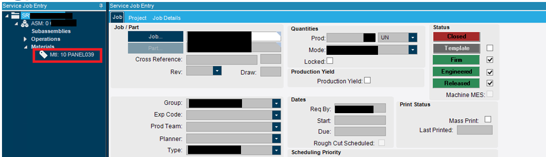

Anyone know why there is no Green dot icon that indicates material has been fully issued even though procurement has completed with the material transfer

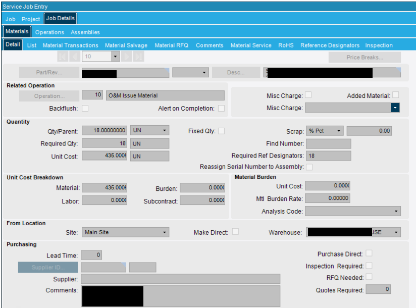

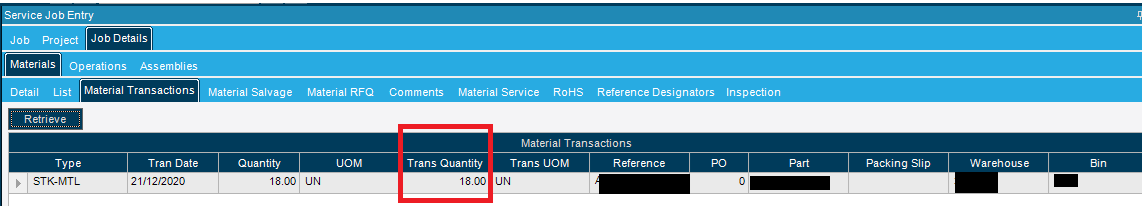

Can you provide a screenshot of the Materials > Detail Required Qty field?
Doesn’t look like it but i’ve heard of issues with almost full qtys being issued like 17.999

I’m running into this now, where job materials are not being marked IssuedComplete, when all required quantities have been issued. The icon shows unissued.

I found a couple causes that explain some of them:
  • If the part is not Quantity Bearing, it can’t trigger the IssuedComplete
  • If the part number was adjusted on the PO, then it doesn’t trigger IssuedComplete. Even though it is setting the IssuedQty correctly…
    But I’m still stuck with hundreds of instances where I can’t see why it isn’t getting marked properly. I’m guessing these are some sort of bug that would take forever for Epicor to diagnose, and then no update for several years…
So I’m making a data directive BPM to set IssuedComplete = true if the issuedQty meets or exceeds the required quantity.
Also seeing that here. We are DMT’ing in job material and labor adjustments before go-live so assume that’s what is preventing it getting IssuedComplete set, as aopposed to the normal “Mass Issue to Mfg”. Another Job Material Update DMT getting its data from a query similar to yours Terry should do the trick to clean up.
