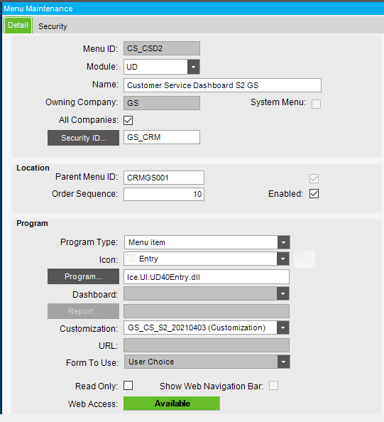

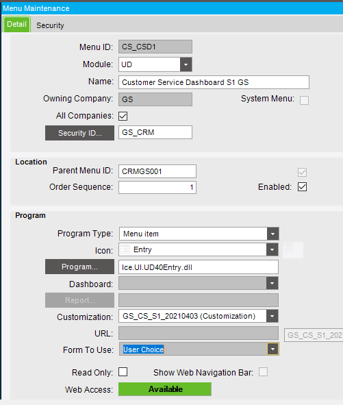

I have two different menu items in the Epicor Menu. They have a customization of UD40 attached to them. The only difference between the customizations is one allows panels to pop out and one doesn’t…basically it is just based upon user preference. At this time I am having to maintain two different customizations and I would like to just have one. I would like to be able to identify which menu they clicked and then set the tab floating preference based upon the Menu name they clicked. How would I go about determining which menu item was clicked? So for instance if they launched Menu item “CS_CSD1” it would allow tab floating and if they clicked “CS_CSD2” it wouldn’t.
