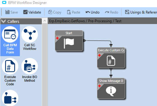

I then created a pre-processing method directive and tried getting a message box to appear.
If I entered a valid Employee ID the message box would appear, and if I entered an invalid Employee ID the messagebox would still appear followed by an error that the ID wasn’t valid.
This is all working as expected but once I tried swapping out the messagebox with anything else, lets say a “Set Field” to a static value, it does nothing. If I use “Set Field” and even put a message box after that widget, I’ll still get the message box to appear without any fields getting set. Any thoughts on how to go about this?

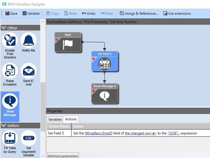

Can you post the bpm you have created?
Here is is. It doesn’t set the field but I do get the Messagebox to appear.

This was just an example to try seeing if I can set any fields.
I am looking to set the EmpID based off their Fab Number from a query, but it doesn’t look like it is setting any fields for me. How would I go about that in a customization?
In a GetRows method, there are no Changed rows, so that’s why it doesn’t do anything. Your “Set Field” widget is setting the value on Changed Rows only.
You wouldn’t want to do this in this method period… but just FYI that’s why it’s not working in this case.
If you want to use BPMs:
You would use a pre-processing on EmpBasic.GetRows,
You would run your own query to get the real employee id,
and you would replace the whereClauseEmpBasic parameter
with the real id.
whereClauseEmpBasic would come in as:
whereClauseEmpBasic = EmpStatus = 'A' AND EmpID = '01389FOBID1378etc' BY Name
but needs to go to base as
whereClauseEmpBasic = EmpStatus = 'A' AND EmpID = 'realEmpID BY Name
That should let you do what you want.

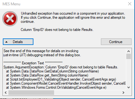

So I tried using your code skeleton and things went well. I was able to insert a query and get the parameter filled with it. However there is another thing I overlooked, there’s 2-3 more methods called afterwards that probably need their parameters edited. For some reason I thought filling in the first method called would then fill in the next method with the edited parameter and so on.
What would be recommended to do now? Should I set up a bpm on these other methods to update the parameter like I just did or would it be better another way?

So currently here is my BPM after using your skeleton for EmpBasic.GetRows method
Here is the custom code
// set variable for entered fob ID
string fobIDentered = whereClauseEmpBasic
Func<string, string> GetRealIDHere = (fobID) =>
    //Do a query here to get real ID
    string fobIDquery = fobIDentered.Substring(29,5);
    string EmployeeID = (from EmpBasic in Db.EmpBasic
                   where EmpBasic.BadgeID_c == fobIDquery
                   select EmpBasic.EmpID).FirstOrDefault();
    return EmployeeID;
if(callContextClient.AssemblyName == "Erp.Menu.Mes")
    string fobID = whereClauseEmpBasic.Replace("EmpStatus = 'A' AND EmpID = '", String.Empty).Replace("' BY Name", String.Empty);
    string realID = GetRealIDHere(fobID);
    whereClauseEmpBasic = $"EmpStatus = 'A' AND EmpID = '{realID}' BY Name";
At the end of the BPM I have it show a message of the whereClauseEmpBasic parameter
After testing the BPM with 56885 it is returning this message
This is exactly how that parameter should be formatted. However it is followed by a couple pop ups saying the Employee ID isn’t valid. So then I check the trace log and it looks like it isn’t updating the parameter in the log. Still using the key fob number 56885.

I am then getting this error.
Sorry if I plugged in the fields into the wrong spots of the code. This is the first time using a dynamic query adapter.
I didn’t actually make a query, so I’m not 100% positive if that’s how you pull it out :slight_smile:
