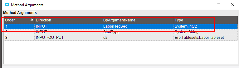

I am having the worst time trying to figure out BPM. I am tying to create a BPM on our MES that will not allow employees to start production on a job if they are active on another. The BO is Labor and Method is StartActivity. There are a dozen ways to solve this problem, my approach was to have a condition option:
The query looks for a row in the labordtl table for a row with the employee# and ActiveTrans = true. If I hard code the employee# it works, but I can’t figure out how to supply the employee#. I think the trace file indicates it is returned in the variable ds. Which I am Assuming is the ttlaborhed table. But it’s not working.

labor.startactivity preprocess take the incoming employee ID and do a query condition where labordtl.activetrans =1 for that employee. Warning do not join the tt table to the db table directly in the query editor that is a recipe for massive slow downs. You might have to use other widgets to extract the employee ID into a variable first. Once you have your query squared away for 1 or more results throw an exception on true.

Honestly even better after looking at the method definition, just look up Erp.LaborHed using the hed seq passed into the method directly and inner join that to labordtl on their normal keys and look for an activetrans
Query in TSQL would translate to
SELECT
FROM
   Erp.LaborHed h
JOIN
   Erp.LaborDtl d ON d.Company = h.Company AND d.LaborHedSeq = h.LaborHedSeq
WHERE
   h.LaborHedSeq = @LaborHedSeq AND
   d.ActiveTrans = 1
If you find any rows throw an exception.
