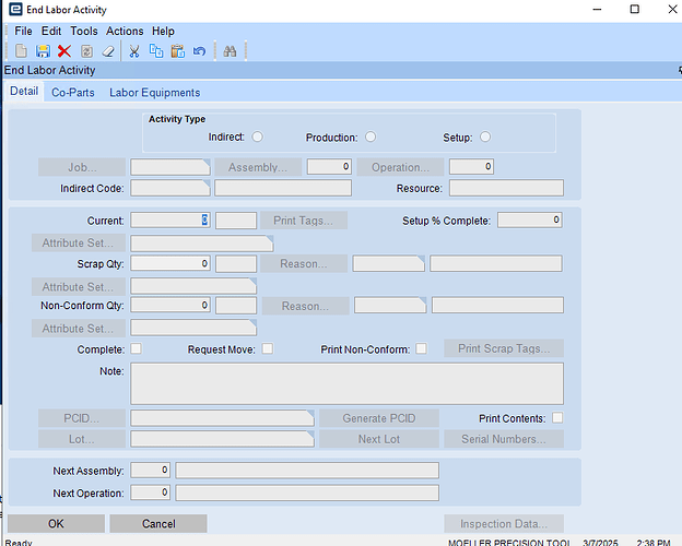

I’m trying to make a modification to MES to where when a job is clock into from a certain department, it automatically launches the End Activity Window after they finish clocking in.
I’ve never done a customization before, so I’m not sure if i’m going about it the right way. below is the script I’m using in script editor, it is launching the window, but it doesn’t seem linked to the job. I’m getting the application error below after I clock in.
and then it opens end labor activity, with no information like job number linking it to the job.

Edit: Lots of forms require the use of launch form options to pass data into them when you open them. This is one of them.

I am trying to open the end activity report, as the company still wants them to be able to enter the information such as quantity/scrap/DMR. I would much rather have it automatically close the job out (and I made a version that did just that) but it was shot down, so this was the compromise, all I’m looking for is for it to open the end activity window after they have clocked into the job automatically.

Take a look here for some info on using lfo when launching forms.
