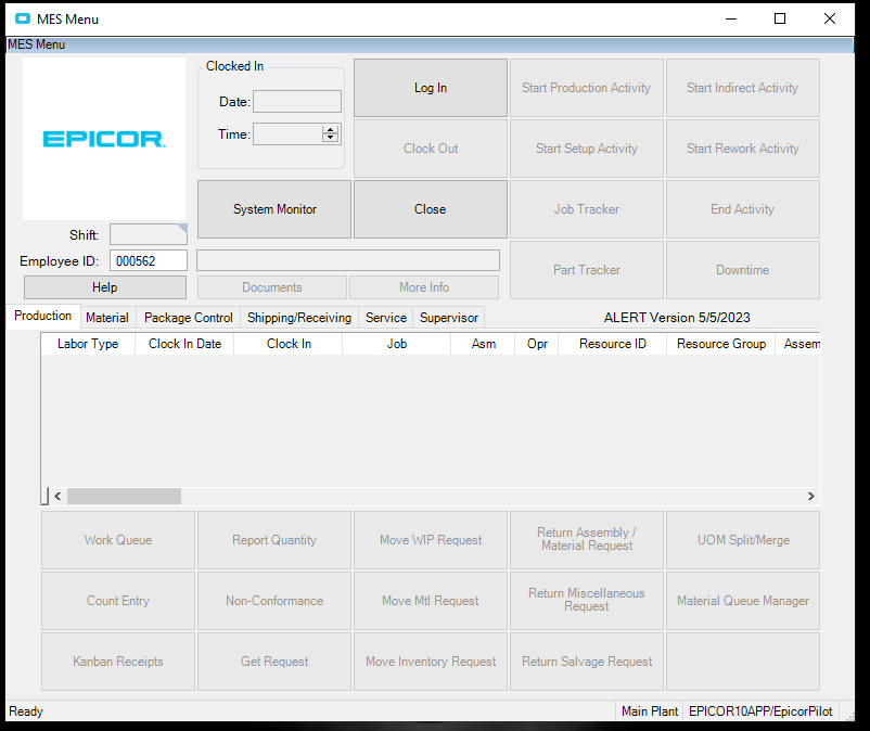

My Mes Screen does not update to show that the current EmpID is logged out after creating an IND labor detail record. If i could get that to work I would be good. Here is my code where I created the record and then try to log out. What am I doing wrong that does not allow the MES Main form to clear after the btnLogOut.PerformClick();?

Yes the button works when you click it manually.

oTrans.ClockOut(); does work but it does not clear the EmployeeID box
It Looks like it gets reloaded after the oTrans.ClockOut
