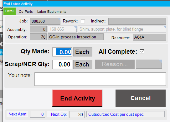

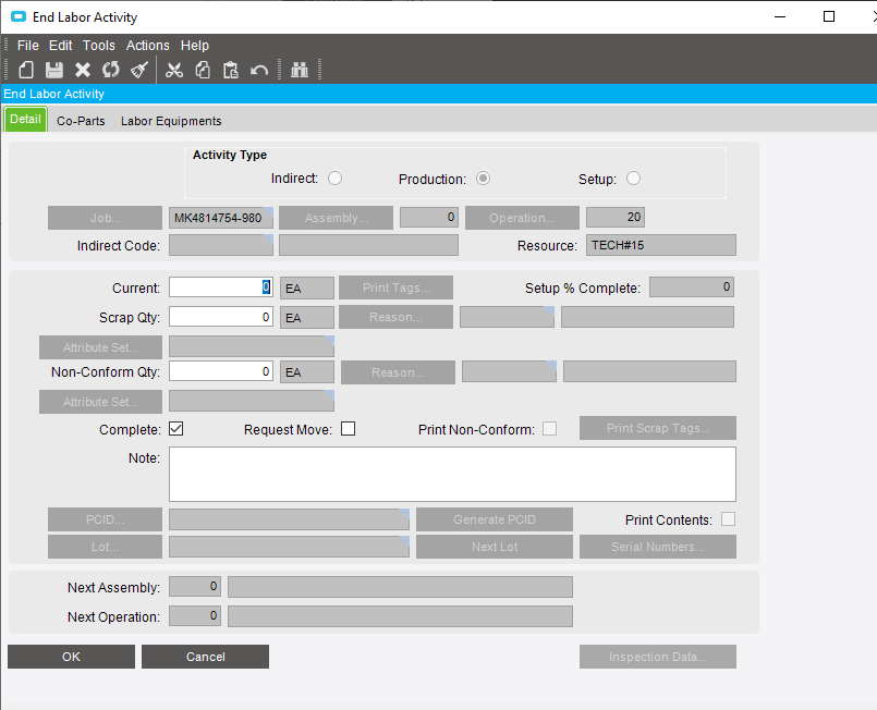

Could really use some help in getting the Next Assembly, Operation fields to display when you End Activity in MES. These fields are always blank when I clock out of a job operation. I have seen screen shots online of other users and for some reason these fields work for them.
I cannot find a company/site setting or anything in Operation, Job Entry, or other menu’s that describe how to enable these fields.

Any ideas? Why are these fields greyed out when there are subsequent assemblies or operations?
Odd, they should just show up. Does the operation have a valid resource group? Is the job scheduled?
Send some more screenshots of your job settings.
I’ve customized the End Activity screen, but those fields just worked OOTB.
Ending activity on a job in MES - same screen on different job operations.

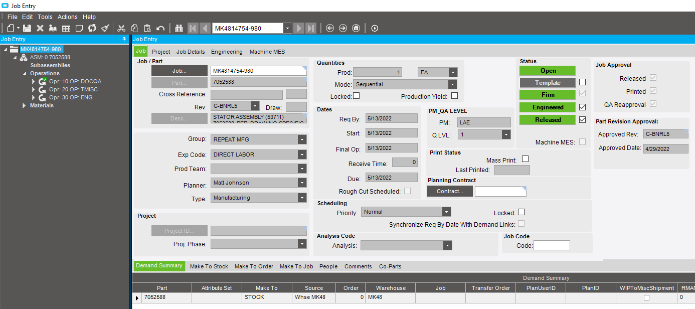

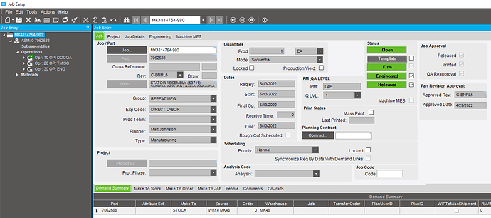

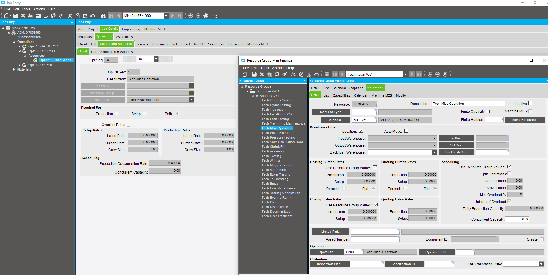

Job Entry for said job:

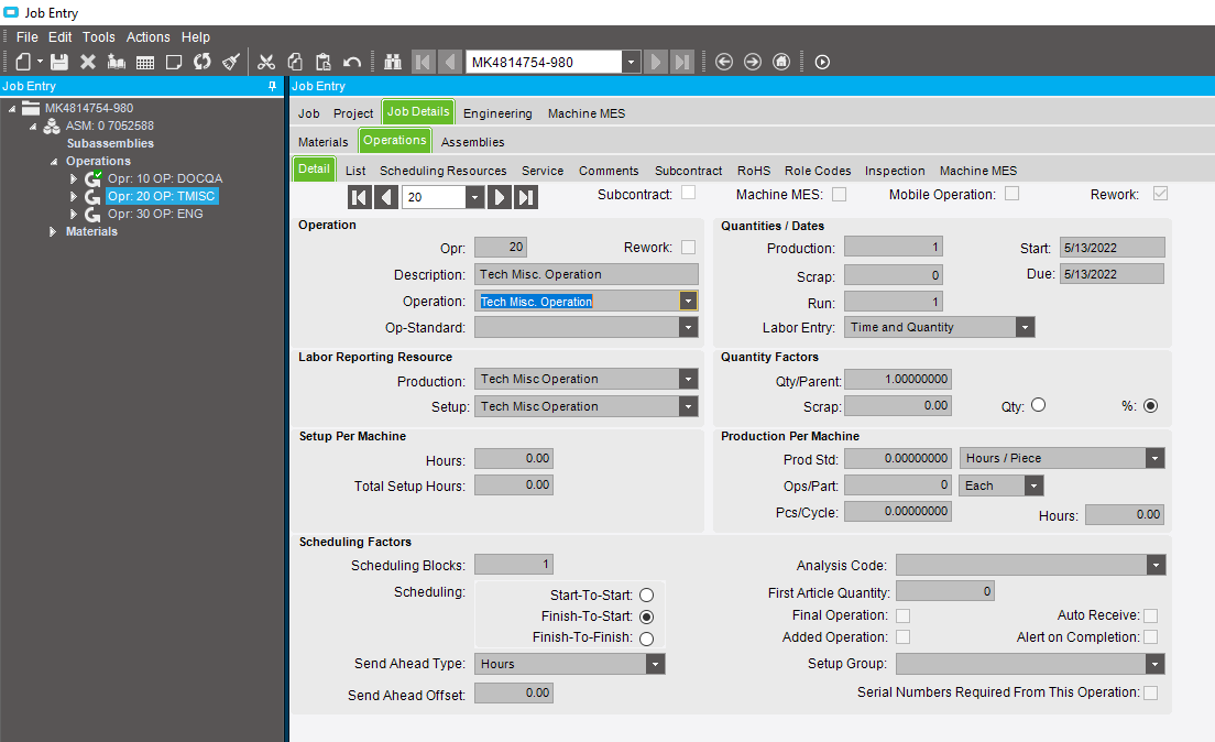

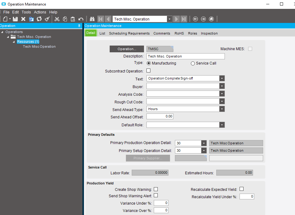

Operation Setup:
Resource is active and valid far as I can tell:
I do not understand why following assembly/operations do not show up on the End Activity screen. Without these fields being populated I am unable to create my BPM email alert.

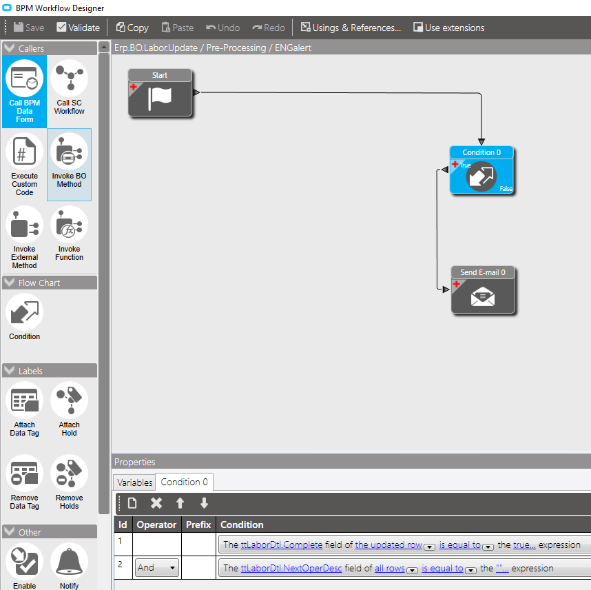

When creating a send email alert BPM (pre-processing Method Directive ERP.BO.Labor.Update) there are fields for NextAsm, NextOprSeq, NextOprDesc which is what I am trying to use in my email alert. Since MES is, for some reason, leaving the next Assembly and Operation fields blank which is my real issue, I cannot use these fields.
Specifically, I am trying to create a BPM that will send out an email notification when the next job operation is ENG or, Project Engineering. Engineering will get the email when they are up next on a job operation.
I would like to know why the next assembly/operation fields are blank for my environment when I see other users do not have this issue. I could not find a site/company setting nor any specific flag in Job Entry that would prevent this from showing up. If those fields start populating as they should be I can then add to my BPM condition statement and send out the email alert.
Below is the BPM currently. Note that the second line of the condition only works currently as “” meaning blank. Since the next operation description is not being populated correctly the email will only get sent out if the condition is set to blank.
Here is what the email looks like. I included the fields mentioned earlier to see what would come through:
Next Operation Seq and Next Operation Desc are blank.

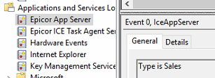

Ice.Diagnostics.Log.WriteEntry("in set next step");

  3. WriteEntry writes to the Event Viewer on the App Server. I use it to see values or know a section of code ran.
