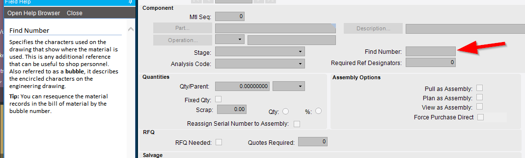

The field “find number” is the field that is designed to hold your drawing numbers.
You’re not locked into 10, 20, 30, … it’s just the default. And I believe you can even resequnce them, selecting the gap/spacing. Order by current seq or FindNo.
Where’s that option?
Oh jeez - that’s great. Thanks!
If you get those in there, then re sequence by find number, your users will figure out pretty quick that you just drop the last 0. (It’s easier than fighting the system)
OK that worked. :grinning:

@jimship - did it just use your FindNum for the order? Or did it use them as the new Seq too?
It used the Find numbers to put them in order, then used 10, 20, 30, which is probably OK.
