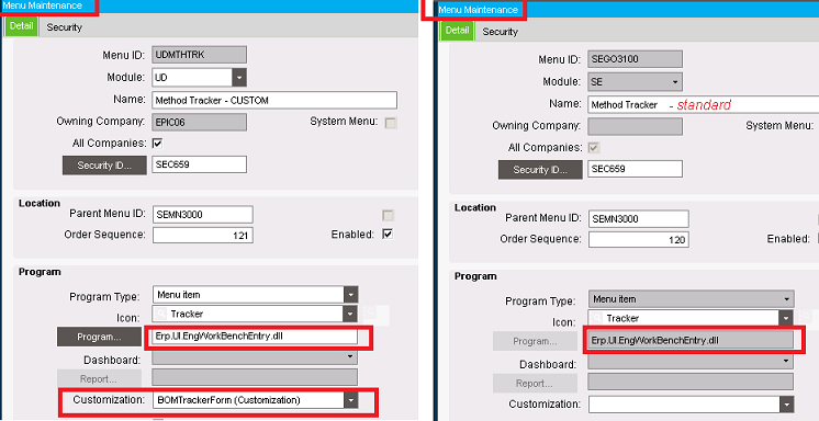

When I added the menu id to the script in MES for the added button, it opens Engineering Workbench. When I look at menu maintenance I can see it calling for the EngWorkBenchEntry form.

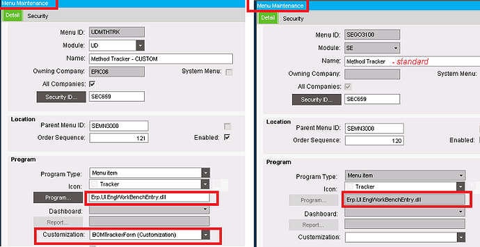

I ended up using a customization for that program ( Erp.UI.EndWorkBenchEntry.dll )
Attached a copy (10.1.6) and some screenshots below…

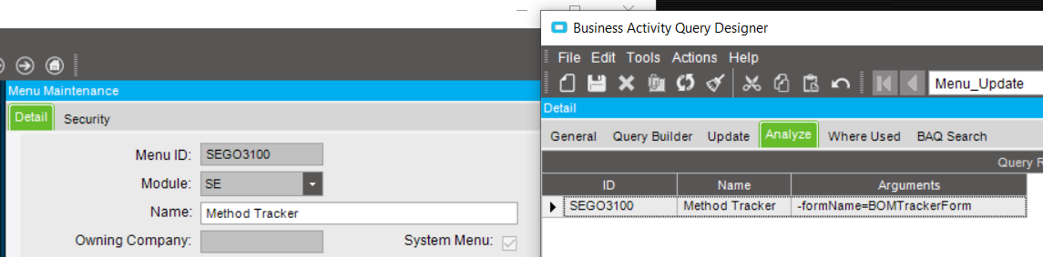

Some of the Epicor menus have a attribute that you can’t see in Menu Maintenance called Arguments:
Off the top of my head PO Tracker is the same. I use an uBAQ to search the original Argument then update my new menu
There is an argument that gets passed. I have a UBAQ out there to see/modify those arguments. Check out what’s on the method tracker and see if applying that do your MES menu will fix it.

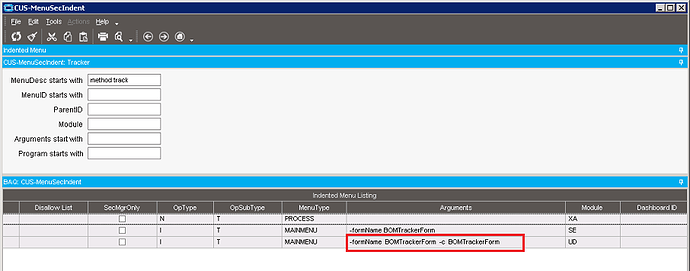

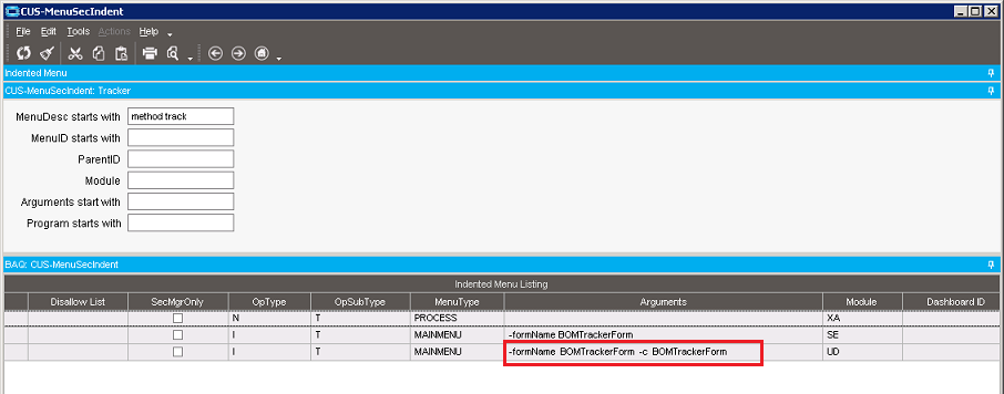

I remember at least once having to manually modify the arguments some menu item since the menu editor wouldn’t save args correctly (but… now I’m not sure if that was my custom method tracker or not.)
Ref screenshot of args for the custom method tracker menu item on a test system

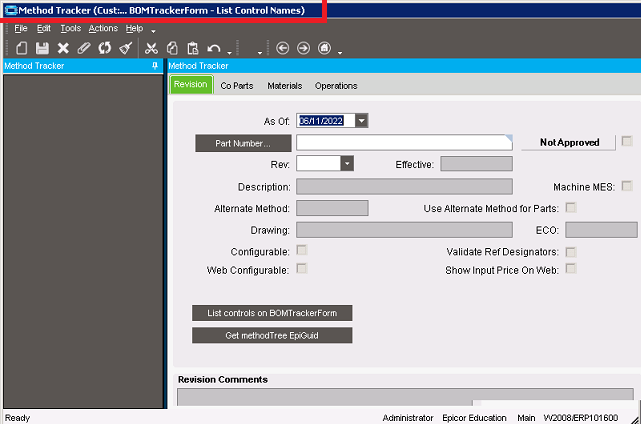

Yes NOW that I tested this in MES…I see what you mean.
I assigned my custom method tracker to an MES button… using button_click.
e.g. ProcessCaller.LaunchForm(this.oTrans, “UDMTHTRK”);
BUT… when I click the button in MES launching the standard Eng Workbench
hmmmn… from the E10 menu… UDMTHTRK launches the correct custom form.
