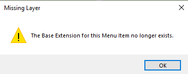

What if customization needs to go with Base Extension?
My argumet string is -formName BOMTrackerForm -c customizationName -be baseExtensionName
And I’m getting this mesage when I try to open Method Tracker.
