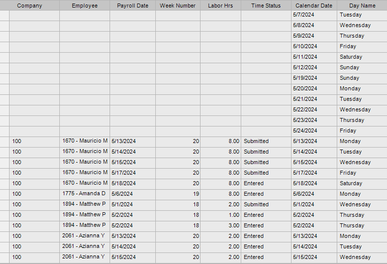

I was able to build the BAQ/Dashboard but unfortunately, is working for 1 employee at a time. If I want to pull the all the BAQ will show only date where ALL employees missed entering time.
This is what I have:

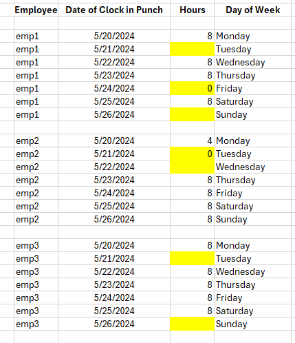

This is what I want:

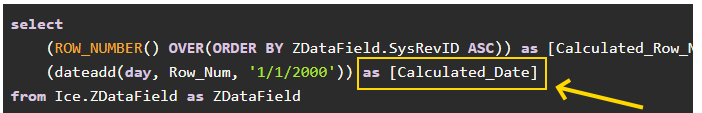

He’s showing a calculated field here…
So, in your BAQ, add the zDataField table.
Then create a calculated field (@NateS simply called his “Date”… I highlighted below).
The rest of the text is what he used as his calculated field expression.
Keep in mind, this was his main query. He then used subqueries to look at other tables (LaborDtl) against the main query date resutls.
I get it now, thanks!
I created a calculated field for “Row_Num”.
Then used that to create a calculated field for “Calculated_Date”.
