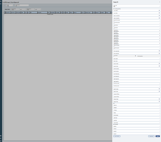

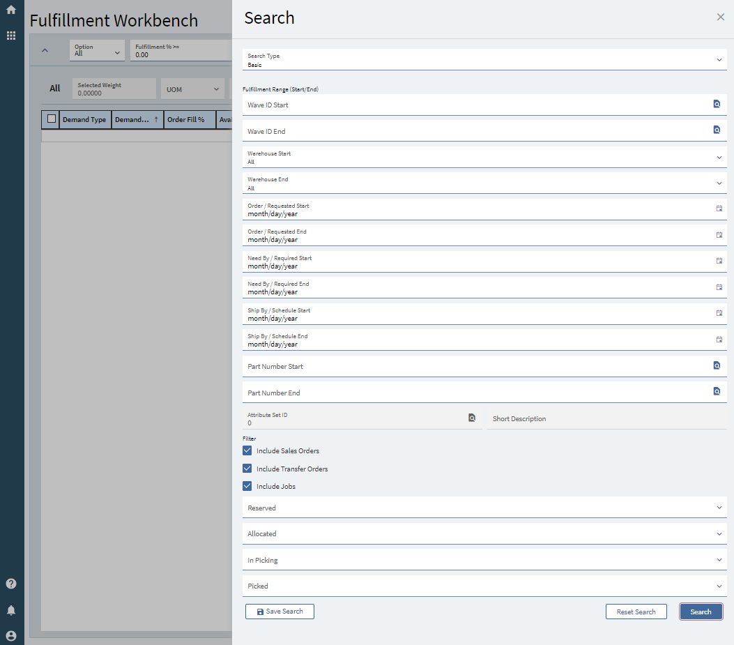

I came to this thread with similar goal of understanding how we can modify the built-in search slider panel layout because some of them are really bad.
Take a look at this Fulfillment Workbench Search panel for the default option All (had to reduce the browser to 75% to fit it in one screen).
It’s even worse for the Order option. (50% to fit it).
We cannot tell our users to scroll to the bottom to hit the search button. If they didn’t click anywhere else they can hit the Enter or Space key to trigger the search but they won’t remember to do that.
For some simpler Search we could replace the tool completely with a custom layout using BAQ but with others like this one it seems more challenging.
With 2023.1 Epicor claims they improved the use of screen real-estate but they still need to do more work. Bottom line, I wish there was a way to tailor the built-in Search. I haven’t check Epicor Idea but this may be there already.
