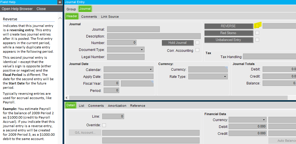

Both periods are in fact still open… If an accrual entry in April that’s reversed in May is the way to go, Could you guide me on how to go about this? What does it look like in Journal Entry?

In 10.1.600., I would check the Reverse check box.

JE entry with immediate reverse would be your next option.
