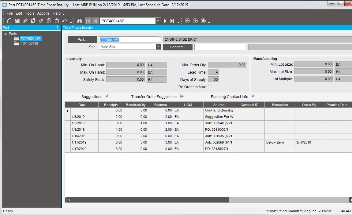

Finally, can you post a screen shot of the time phase of the part in question? That would help us understand what we are looking at better.

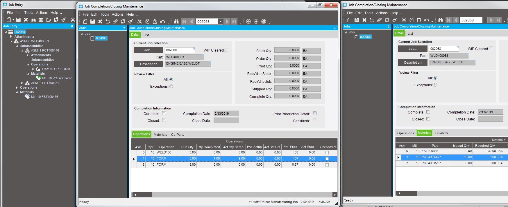

Q3. In screenshots below, I entered a scrap quantity of more than the sub-assembly required quantity of 9. Only 1 was enter as Qty completed. Ran MRP and tested using time phase, job does not show any requirements for the material under this operation, due to it issuing complete.
My thoughts back flushing reacts to quantities entered and treats a Qty Completed and Qty Scrap through MES the same, issuing materials to the job. The sub-assembly in my example has 1 Qty Completed, but does not reorder the materials to produce more sub-assemblies based on Qty Scrap of 9.
I see requirements for 6, a PO for 1, a PO for 3, and a suggetion to buy 2 more for a total of 6.
I still am not seeing what the problem is.
edit now I see, you should see requirements for job 002068

So the core of the problem is that an ASY has had all the required material issued to it, but the ASY is not yet complete?
That entering a scrap qty for the ASY issues materials against it, but still marks them as issued complete?
Yes Calvin, you have explained better than I did.
