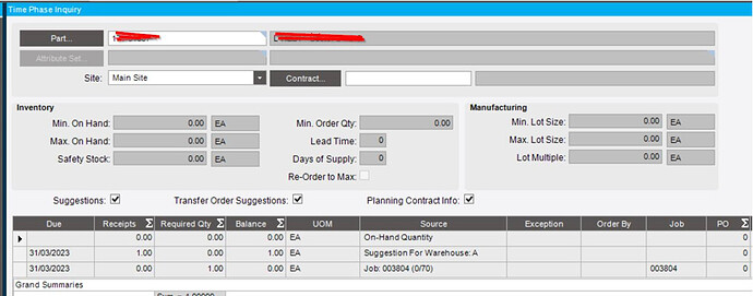

last one is interesting… in time phase I can see PO suggestion is created for buy to inventory but I can not find any PO suggestion to convert that in to PO at purchase management PO suggestion screen ,which is really strange. So , Job has not been created and now cant find PO suggestion as well.
Vipul,
What exactly does the text say in the source field for timephase? Does it say something like ā€œSuggestion For Warehouseā€? Want to show screenshot of it plus perhaps the method of the parent expanded?
Nancy
Refer the screen shot… Yes it says suggestion for warehouse A , it is our main warehouse which is correct as all suggestion created for that warehouse only.
Method for parent isn’t fancy we have not created MOM for it yet as we are only looking material at this moment. Child set as View as assemblies / no purchase direct ticked.
