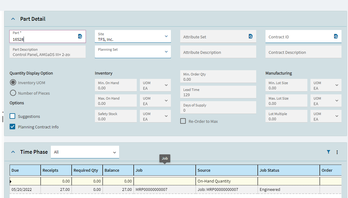

MRP is creating suggestions for parts that do not have any demand.
The part has no safety stock or Minimum on Hand
The part’s parent parts do not have demand, safety stock, or minimum on hand…
I am not sure where else to look, all suggestions are appreciated.

If you check the “Suggestions” checkbox, it may give us some more info to go off of.
MRP will generate jobs for parts with On Hand quantity below 0 to bring you up to 0.

Right, however there are two jobs already filling the current demand and getting us back to zero.

Are there other sites with demand?

The only way to do a full regen is to do it for all parts. You should notice that if you filter for a specific part, it will switch to “Net Change” and become a gray, unchangeable option:
