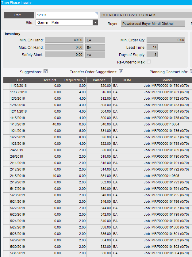

We’re having an issue with “SOME” part, all component parts, where MRP is suggesting we build parts where there’s no demand. I’ve included screen shots below of a component part that we’re having problems with.
From the screen shot above you notice the balance increases all the way to 330.00 pcs and never nets out to ‘0’.
Here’s the top half of that same Time Phase:
Does anyone have any ideas on why MRP is doing this and how to fix this issue?
I appreciate any help,
Jonathan

it would be interesting to see what happens if you changed the Min Order and Max order size to zero, and only left the MULT at 40… wondering if that might be confusing something.
We tried that as well as the Days of Supply. The calculation still comes out wrong.

Not a clue. We do a Regen every Saturday, that log had nothing that shed a light, and a Net Change through out the week and that had nothing. We’ve been testing by removing parameters and running a Net Change just on one of the affected parts and there’s still no change.
